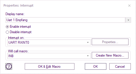

I still have a problem with the Uart1 receive interrupt
Pic16F18877 32Mhz RX Pin RC6 TX Pin RC7
Thanks in advance
