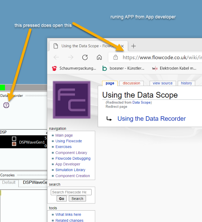

The Datarecorder has a button " ? "
If I press it, in the running app,
it's open the IE explorer with the wiki from flowcode.
A button that I can choose the page...

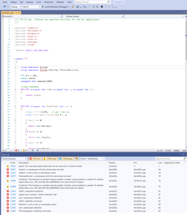

But your sample for the DLL is already old. It's for Visualstudio 2008.
If I open it with VS2019 I get some errors.
I will have look about it

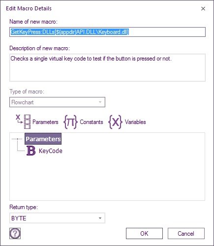

GetKeyPress:DLLs[$(appdir)API.DLL\Keyboard.dll]

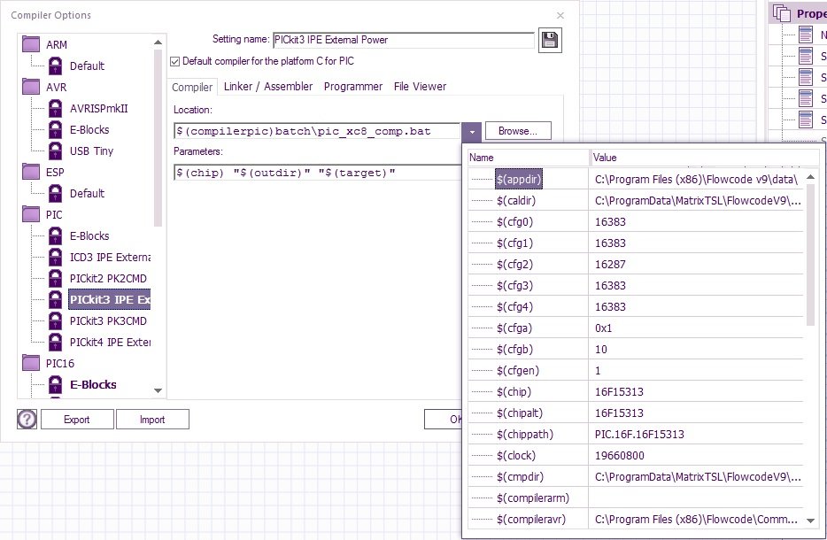

If you look at te Build -> Compiler Options window then you can see all the useful directories available and their variable name.
e.g.
$(appdir) or $(srcdir)
