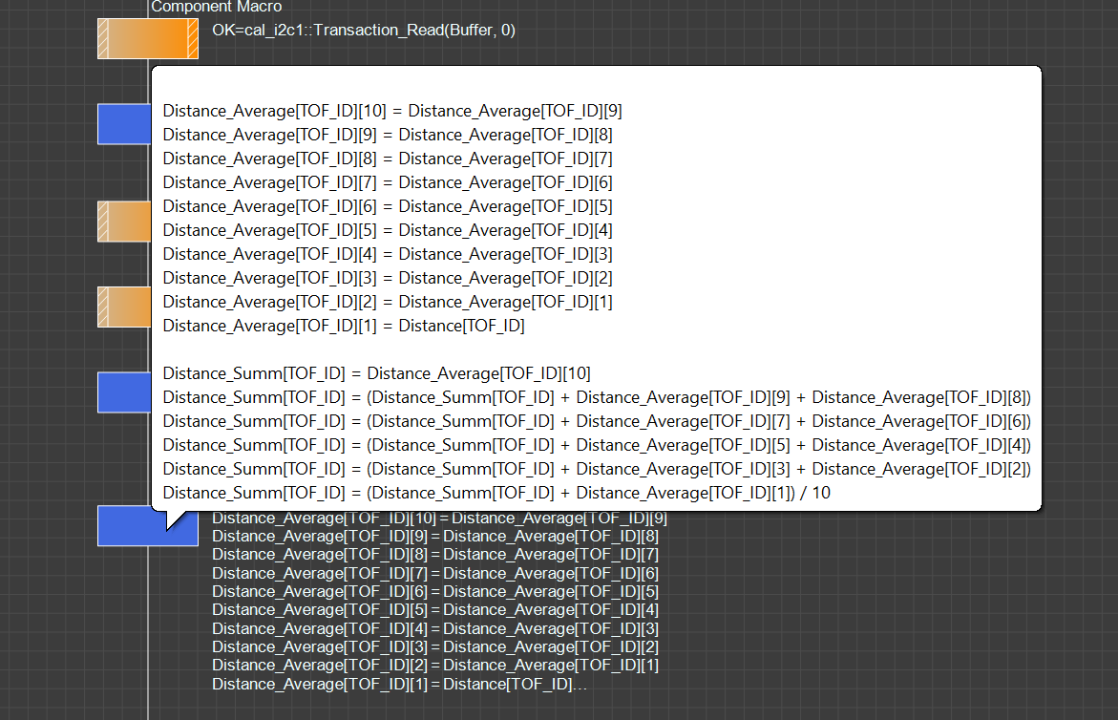

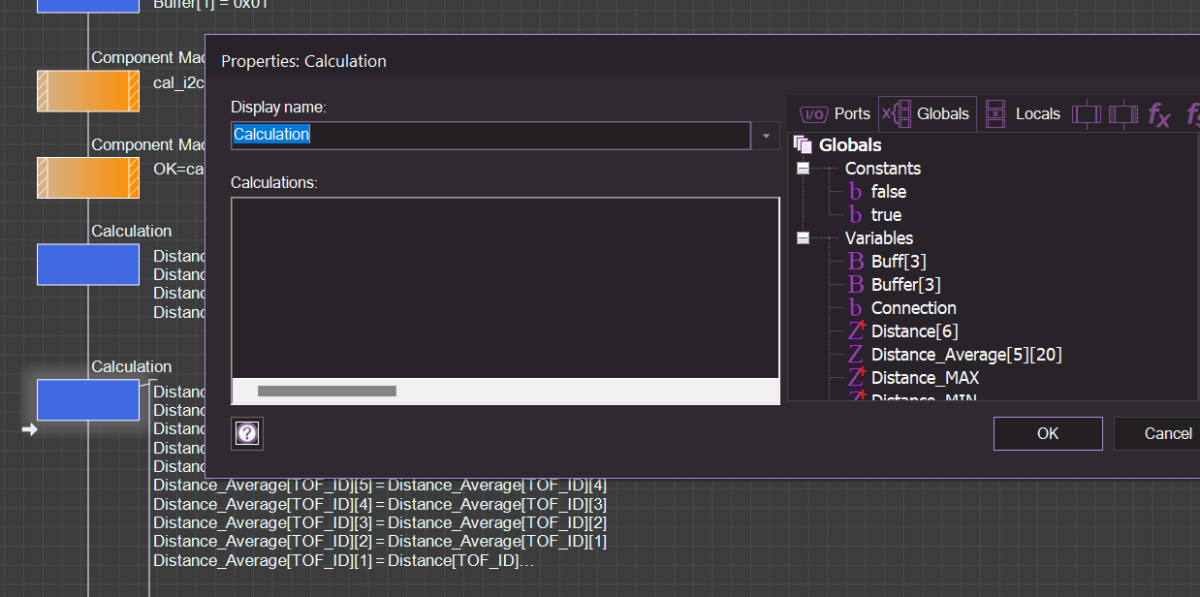

I noticed an interesting phenomenon with the calculation icon.
If I write a relatively large amount of operations in the Calculations window, after saving and reloading the *.fcfx file, the operations to be performed are not visible by clicking the Calculation icon, but they are included in the program when the program is compiled. .
I have attached an example that works like this for me.

Is the first line of the calculation empty? If so make sure there is either a comment or a calculation.

This should work correctly. I opened the source code in a text editor and got rid of the initial blank line in the calculation icon.

The calculations only disappear if the calculation icon is opened and then OK is pressed.
If you notice a project which has this problem, then send it to me (via PM) and I will fix it. Or you might be able to edit the file directly in a text editor and remove the blank line(s) or add "//" to the top of the problem calculation statements.
