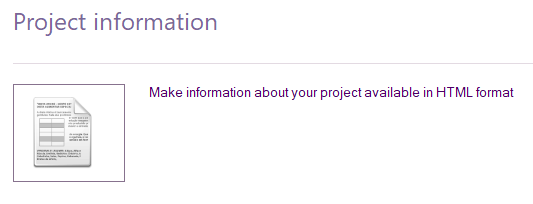

Flowcode has a nice export function and generate a html file with printscreen from all the macros and panels.
under export:
- 2024-06-10_17-41-00.PNG (11.16 KiB) Viewed 4953 times
unfortunately the printscreen of the main is not exported maybe because it is too long?

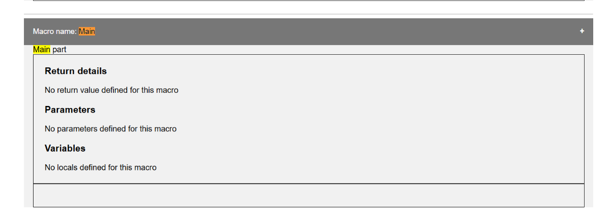

this is the main from my project:
- 2024-06-10_18-28-04.PNG (46.46 KiB) Viewed 4947 times

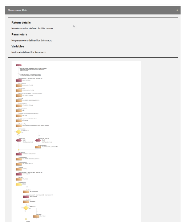

and this from the post_doku:
- 2024-06-10_18-29-04.PNG (64.46 KiB) Viewed 4947 times
Re: Flowcode Project information not complet
Posted: Mon Jun 10, 2024 6:18 pm
by Steve-Matrix
Sorry, but I don't know what the problem is. As you can see from my previous attachment, the macro is correctly displayed when I try.
