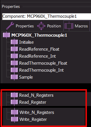

Can you see if the attached works for you.

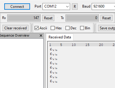

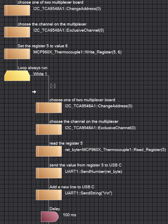

I set in register 5 (SENSOR CONFIGURATION REGISTER) to value 6 (Filter Coefficient) then I read the register 5 and send it to USB C.
Even if i use two I2C multiplexer board it's working nice.
Program:
result in a terminal program:

I will add the component to the release folder so it can be pushed to the update system.
Re: MCP960X thermocouple add read/write register
Posted: Tue Jul 02, 2024 12:48 pm
by medelec35
Hi Stefan.
The updated component should available via the library now.
