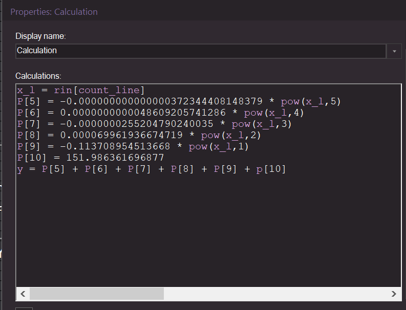

is there anyway to fold a long line of code inside a Calculation icon?
(this is to reduce the width of the code on the screen)
Flowcode9 Help Needed 02.jpg (61.97 KiB) Viewed 4601 times
Maybe Something like this!

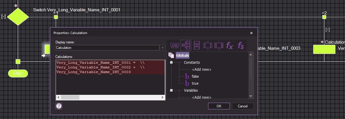

Flowcode9 can we fold the line.jpg (100.3 KiB) Viewed 4601 times

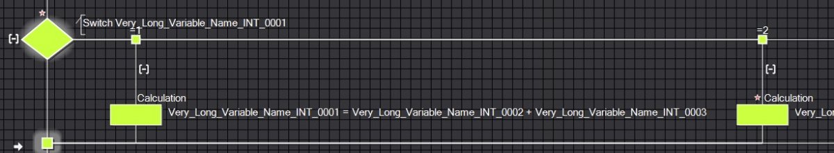

There is a setting in the Global Options that can control this to some extent. This is "limit annotation size for new icons" under the "Flowchart" tab.
However, this only works for newly created flowchart icons.
This setting controls a hidden property of each icon called "textarea". You could change this manually for any icons by directly editing the project fcfx file in a text editor. Of course, if you do this then be careful - make a backup of the file and change only the specific entry.
The attached project shows what I mean. It has 3 icons. The first was added when the annotation size limit is off and the second was added when the limit is on. The third is one where I have manually added the "textarea" for the icon within the project file.

I also had to use a long formula. I then made an array P[] with float and added it up like this:
