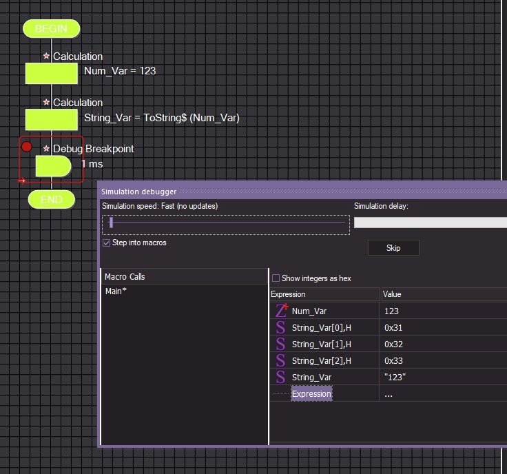

Hi Dirk
do you want to convert INT or Byte to STRING ( String is an ARRAY of BYTES)?
Just check this..
FC INT to String.jpg (95.85 KiB) Viewed 7007 times

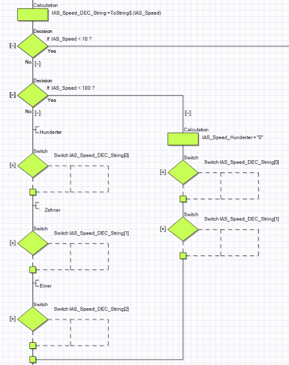

Hello together,
many thanks for your suggestions. I will check it out.
In between I found a way to solve my problem. I used the string function "ToString$" too. After the function I used switch component in order to filter for string element 0-2. 0 is giving me the hundert, 1 is giving me the ten, and 2 is giving me the numbers smaller then 10. Each switch has ten ways.
Each switch way down is giving me the requried ASCII HEX.
Screenshot 2024-08-29 080847.png (102.85 KiB) Viewed 6976 times
BR
Dirk
