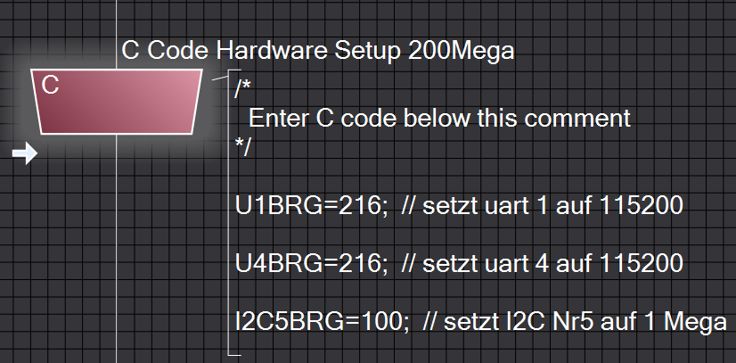

For my PIC32 I used C-code like this

Thanks Stefan,
I change the register values the same way. Using the C code.
My issue is that it can get pretty tricky to calculate what the values need to be for the registers. Then there is an issue that you have to enable configuration mode, make changes and exit, with what looks like some specific checks/timing. Its just a bit beyound where my skill level is at!
