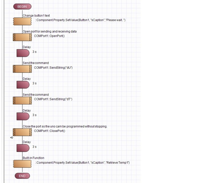

I try send string from PC to the device with PC App USB example. It's my first job with PC App.
I removed all about the receive buffer because the first step for me is send data.
I have two string: "dU" to up the level and "dT" to down the level of the device. Work fine with HyperTerm but nothing with PC App.

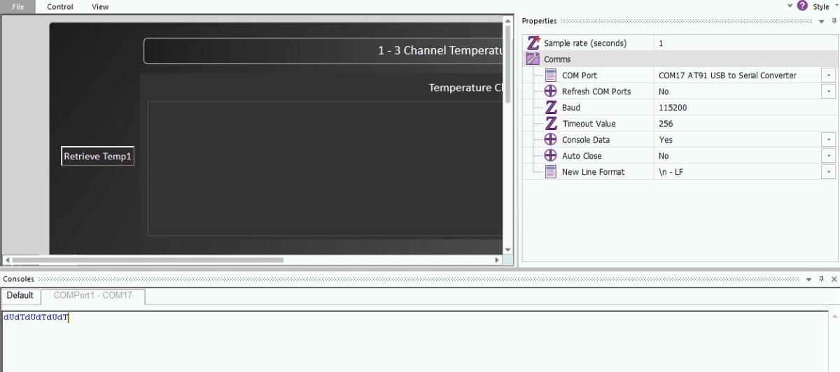

No result with new line character. I have only a new line in the console.
I can connect HyperTerm to my device without problem and send this string. Work fine with a simple com terminal software.
I don't understand why the string is not sent in the com by the Flowcode Pc App.

I connected the logic analyser on the UART. I send all packets from the USB rx to the UART tx.
It's very strange, I receive data but no good.
Nothing with the SendByte macro of the com port component.
The last string with the SendString macro of the com port component.
And some bit with the SendBinary macro of the com port component.
When I test after that with the HyperTerm, I receive perfectly all data. So it's a problem from the PC App.

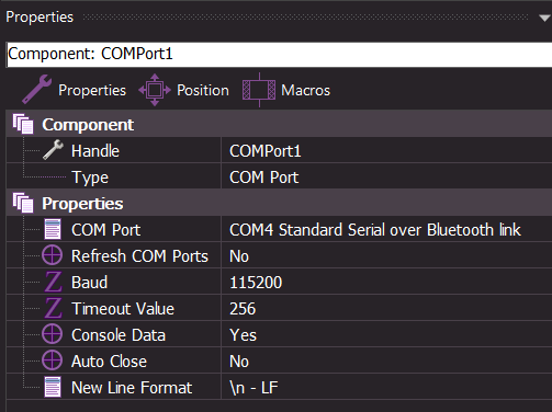

Flowcode doesn't create any kind of lock on VID/PID etc and should work with just about anything. I'm wondering if 3s is enough for the BT pairing to be established reliably. Could you instead have a button to connect, then another button to do the data send and then a third button to disconnect. This way you can connect and then keep trying to send data and then disconnect once the process has been done.

There are sometimes issues when a COM port greater than 9 is accessed. You should be able to change the COM port used by your device to a lower one to see if that fixes the issue.
