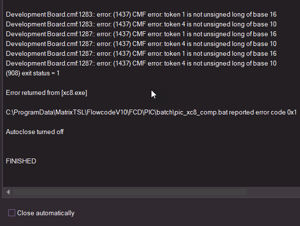

I am desperate to get a hex file out of the attached code but it is coming out with an error. Can someone please try to compile this to hex so I can narrow down the problem.

I also get an error with your program..

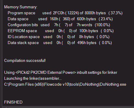

Looking at the CMF file - looks like an easy fix (or workaround) is to rename without a space in the name.
I saved it as db.fcfx and then it compiles AOK
Memory Summary:
Program space used 2FC0h ( 12224) of 8000h bytes ( 37.3%)
Data space used 169h ( 361) of 600h bytes ( 23.5%)
Configuration bits used 7h ( 7) of 7h words (100.0%)
EEPROM space used 0h ( 0) of 100h bytes ( 0.0%)
ID Location space used 0h ( 0) of 8h bytes ( 0.0%)
Data stack space used 0h ( 0) of 496h bytes ( 0.0%)
