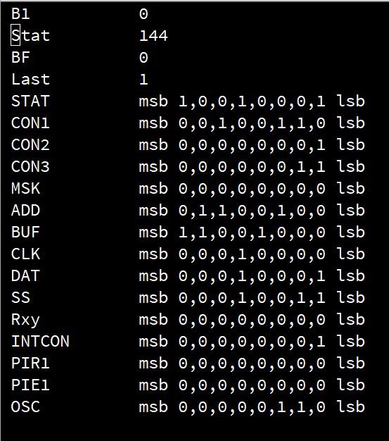

D) I was unsure what was set in the registers so I read out everything associated with i2C and send them to a Terminal program and display them as bits, MSB to the left.

OK, so I have gone back to check the basics. Great info from Martin but I'm not attempting the Interupt approach yet, until I can understand the possible issue with the standard i2C Slave component.
If I use the FC i2C Slave component to retrive the SSP1STAT register and put it in variable i2C_Status, I cant read out values for the (BF) BufferFull bit.
i2C_BF = i2C_Status AND 0x01
i2C_Last = (i2C_Status AND 0x10) >> 4
However If I directly read the Register into my own variable.
FCV_REG1 = SSP1STAT;
then
i2C_BF = Reg1 AND 0x01
i2C_Last = (Reg1 AND 0x10) >> 4
I now read what look like good Values for BF and Last.
So is this a bug or am I doing something I dont understand?
J.
