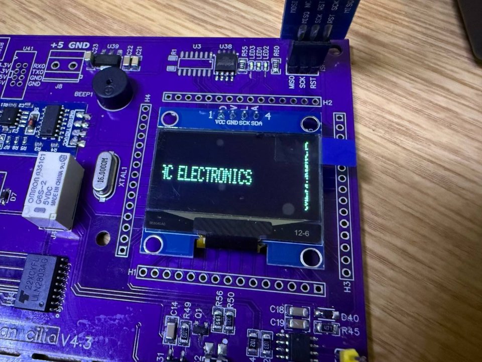

Hi medelec35,
The SSD1315 display also uses I2C address 0x78 and has a resolution of 128x64 just like SSD1306
The display is receiving data and showing Text, but the output isn’t correct. There’s a noticeable offset issue — for example, if I set X = 0, part of the text on the left side gets cut off.
Additionally, the text itself doesn’t render properly — it appears as a series of horizontal lines instead of clear characters ( this issue is also present on the SSD1306 )
There’s also a vertical line always present on the right edge of the display.
It seems like either the initialization sequence or the memory addressing isn’t fully compatible with the SSD1306 driver in Flowcode.
Any advice or ideas on how to resolve this?

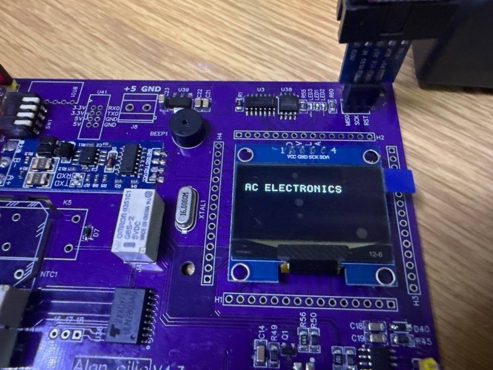

Problem Description:
The display has a 3-pixel offset to the left, leaving a 3-pixel wide uncleared area on the right side.
Temporary workaround :
I tried this C code that initializes the display with a horizontal offset of 3 pixels to the right. This should have fixed it but when printing text it resets
the parameters , So Piexl Width in Properties should be set to 131x64 at least the code fixes the text rendering problem.
Just a quick note: After you apply this fix, make sure that all X positions — whether you’re drawing text, graphics, or anything else — start at position 3 instead of 0.

Re: GLCD SSD1315
Posted: Sat Mar 08, 2025 9:15 am
by Alan_37
Hello again,
After further testing, I discovered that the SH1106 I2C display is fully compatible with the SSD1315—no additional code is needed. The display also communicates on address 0x3C.
The only difference is that the SH1106 has a reset pin, whereas the SSD1315 does not. However, if the reset pin is left unconnected in the properties, the project fails to compile.
If someone could create a clone of the SH1106 without the reset pin and name it SSD1315, that would be perfect.
