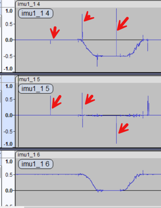

But there are a few errors in the data. I will call these needles. I have sampled the LSM6 in IRQ with the STM32 and there the values are perfect (but I can't save to the Sd-card) One idea is to read the LSM6 more regularly like the STM32.

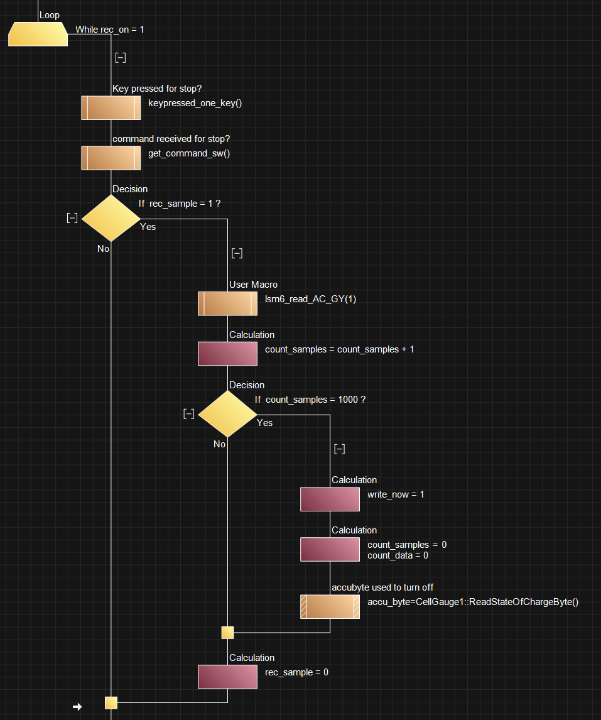

Now I set a variable in the IRQ to read data. But depending on the position in the main(rec macro) it goes faster or slower until the macro is called, irregular reading is maybe not so good.
Accelero data x,y,z with a movement:
read Button and if irq from USB or BT:

The spikes are odd... Do they give incorrect data - or are they so short as to be ignored?
