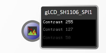

This is the display simulation:
Contrast testing.png (21.24 KiB) Viewed 3417 times
Let's hope the hardware works just as well.
