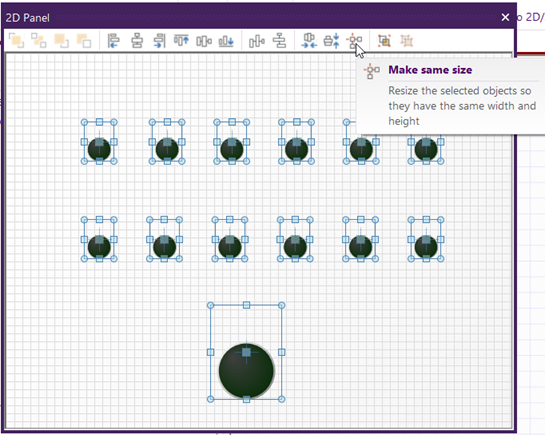

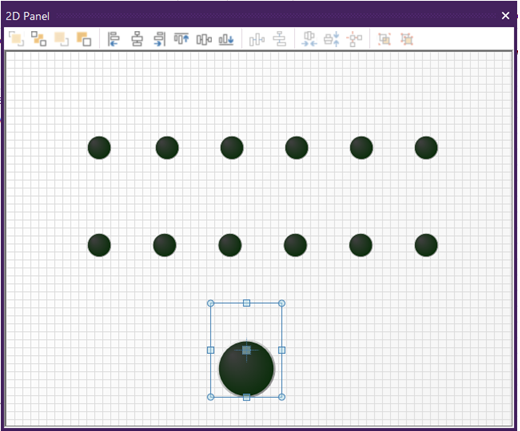

There is an option to make all selected components the same size as the first selected component.
First select the component that is the required size.
Resize 1.png (76.43 KiB) Viewed 5583 times
Hold the Ctrl key down and left click all the other components to want to resize.
Click the resize option on the top of the 2D panel.

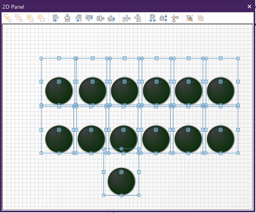

Now all the selected component will be the same size.
Resize 3.png (135.81 KiB) Viewed 5583 times
A tip. When a component is selected, select the Position tab, then select Yes for Lock aspect ratio.
You then then drag the corner to resize and the component will remain in shape.
You then then drag the corner to resize and th component will remain in shape.
