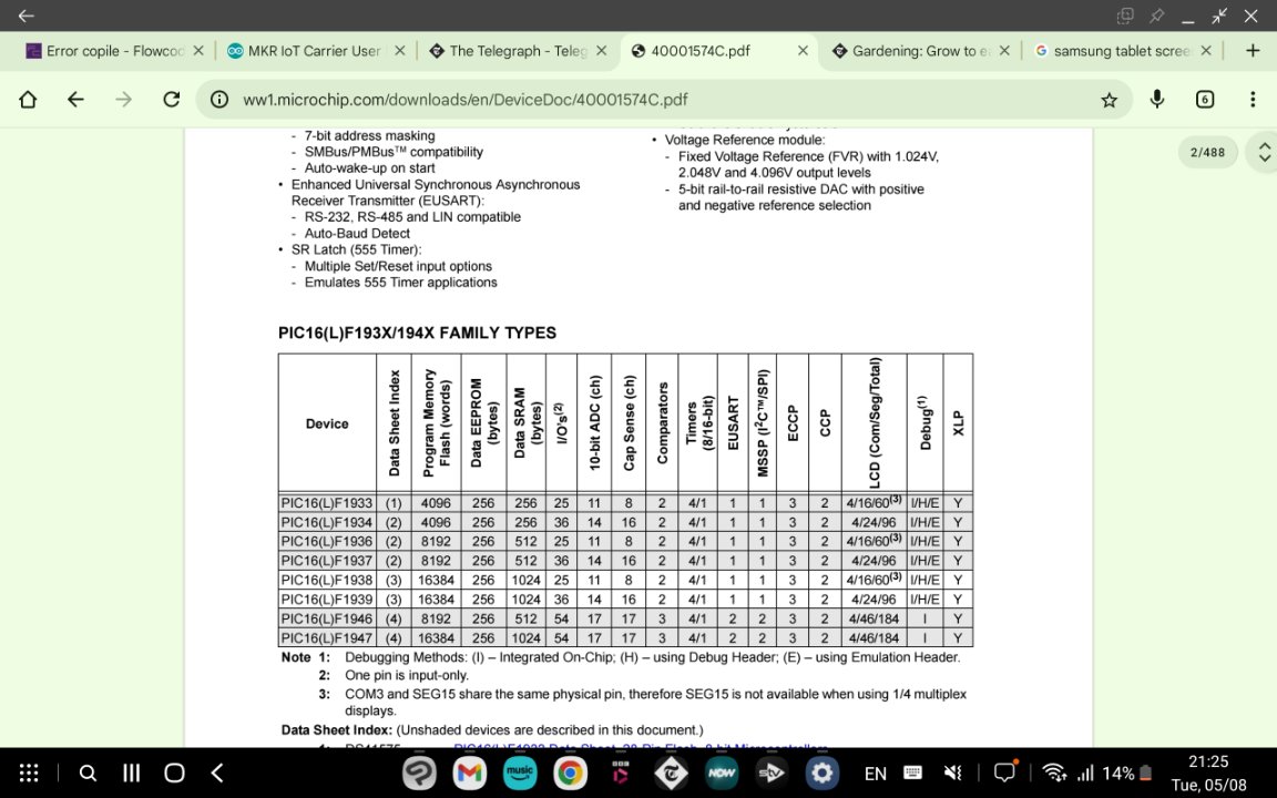

please could you check the following error that flowcode shows me when compiling, I am using the PIC16F1939.
^ (103) #error: "I2C Channel 2 does not have the SSP2IF defined on this chip - does your chip support this feature?"

It looks like the PIC16F1939 only has one MSSP module - so only one hardware i2c channel?
Try using the software channel?

Without seeing your chart it looks like you are attempting to enable an Interrupt on Synchronous Serial Port #2 with the chip only supporting SSP on #1. As far as I am aware, FC only has Channel-1 and Software options, no Channel 2 for that chip.

Whilst you were busy beating me to replying, by sneakily have the datasheet open, I opened up FC and was only allowed Channel 1 or Software, so maybe Enrique needs some turbocharged sleep :)
