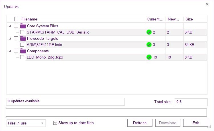

Further to Martin above
I hadn't noticed "Dropbox" which has in the past caused issues for me (and others that were not local). I've also had issues with spaces in the file name but offhand I can't remember what I was compiling too.
These are current component versions and my locations, if it helps.

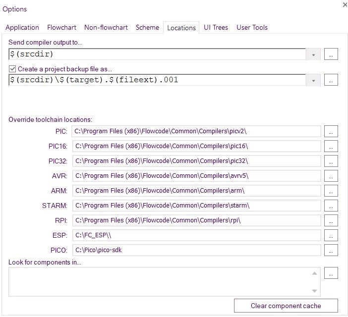

Hi, thanks everyone for your support.
I've always used Dropbox. The files are in a folder on my PC and then updated on Dropbox, and it's never given me any problems. I put the LED file in another folder on C, but I get the same error. Now I've downloaded FC10 to a laptop connected to Dropbox, and the compilation works. I'm attaching a screenshot of how it's set up on my desktop PC.
