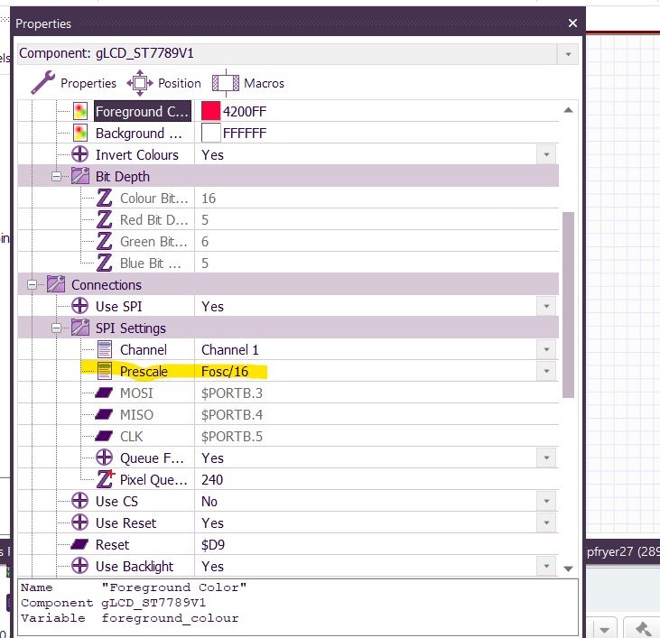

Re: ST7789 gLCD and Arduino nano- Slow Display response
Posted: Sun Sep 28, 2025 4:15 am
by chipfryer27
If you go to properties on the display, scroll down you will see option for scaling.
Screenshot 2025-09-28 041404.jpg (100.15 KiB) Viewed 7802 times
Posted: Sun Sep 28, 2025 9:36 am
by ifrdbcsirbd
In the V9 there is no SPI property of ST7789.
Posted: Sun Sep 28, 2025 11:32 am
by chipfryer27
Sorry, I overlooked that you were using v9. Unfortunately I don't have v9 on this laptop.
