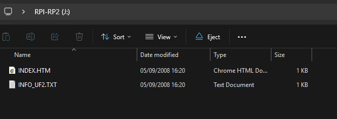

You can get the Pico into boot mode by holding the boot button down, then plugging in the USB cable.
A window should pop up like this:
Pico Boot mode.png (16.83 KiB) Viewed 4260 times
It's just like plugging in a USB flash drive.
When you use compile to target, Flowcode will transfer the correct file to the above directory and the directory will be automatically closed.
The Pico should then be programmed.
