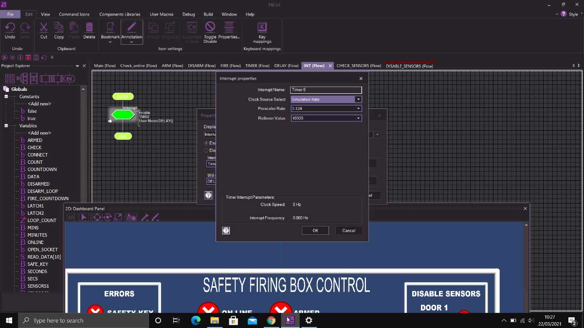

Since i had the problem of not being able to open the project i now have a problem that the interrupt does not have a clock frequency.
How can i fix this i have tried the following.
1. delete the interrupt icon and replace.
2. unistall flowcode v9 and reistall.
but still not working.
Thanks,
Wayne M

Thanks for the file fix but still have problem with the interrupt having no clock frequency.
Thanks,
Wayne M

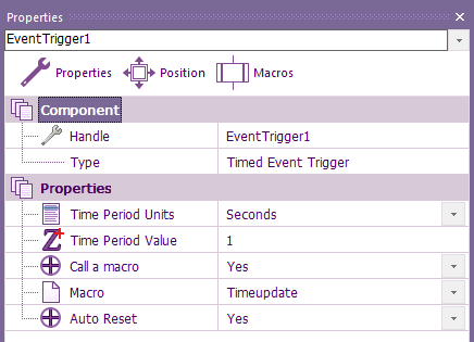

In that case you don't really want to use the interrupt.
Use the Timed Event Trigger instead.
I was really amazed at the accuracy!
Much better than interrupt.
I Ran it and compared with a stopwatch.
It was still spot on to the second an hour later.
It's easy to set up for 1 second intervals:
Timed Event Trigger.png (17.9 KiB) Viewed 11525 times

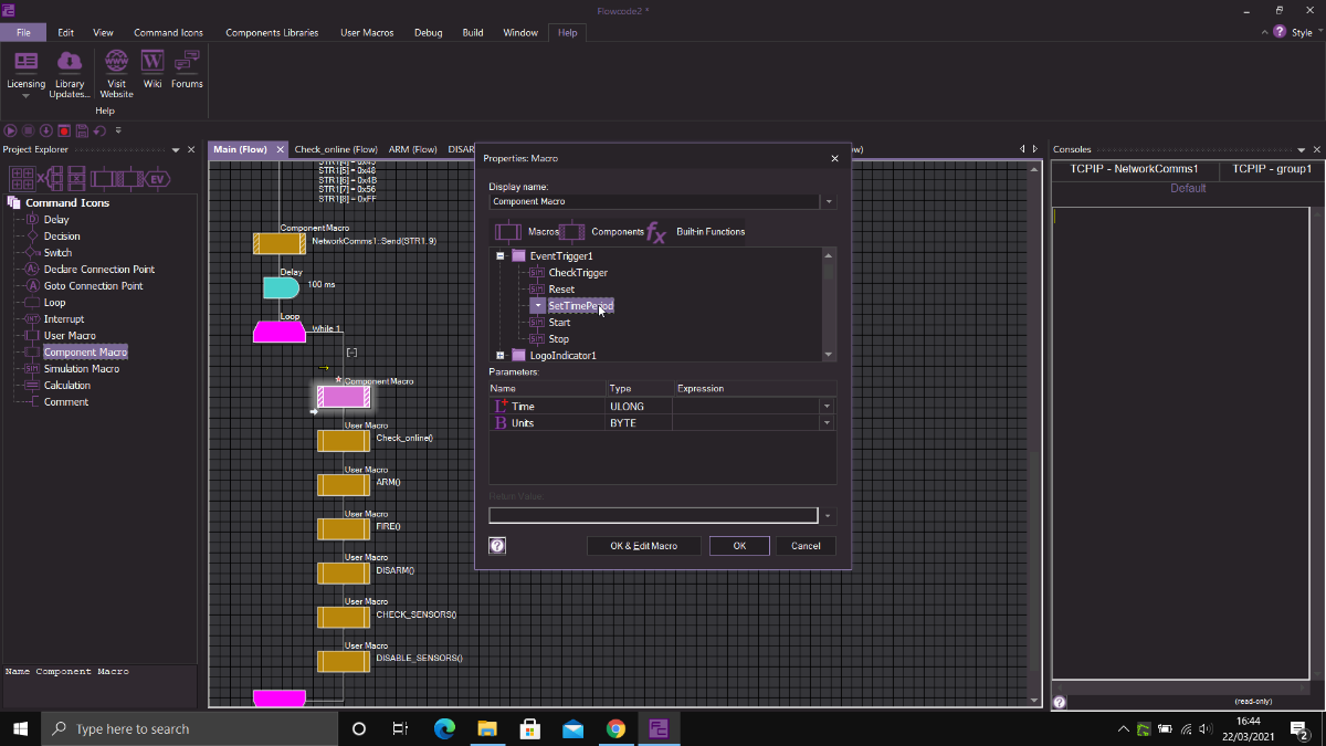

Hi Martin,
I do not see what you have on your event timer.
what am i doing wrong?
event timer.png (183.45 KiB) Viewed 11514 times
Thanks,
Wayne M

by medelec35
Hi Wayne,
What I have posted is within the component properties.
right-click the component on the panel & select properties.
That is how you set up the time the event triggers in.
You don't require Period of the component, only start is required.
