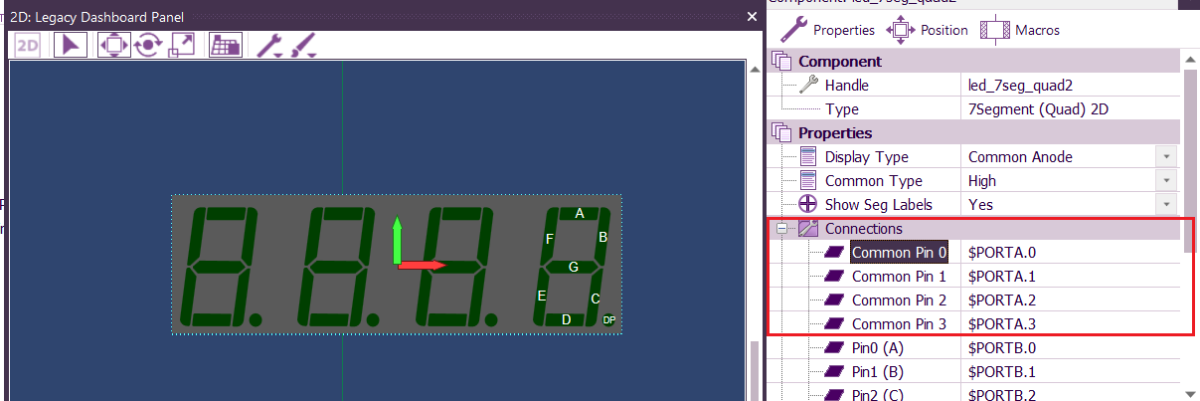

From Ben's post, Please pay attention to this:
BenR wrote:
Thu Dec 18, 2025 10:16 am
It looks like the specific error being generated it due to the 7 segment quad component pin connections, something there is referring to PortA which doesn't exist on the device you're using.
Select the 7seg Quad component on the 2D Legacy panel then right click and select properties.
Within the properties change any pin that has Port A selected.
E.g. the top pin is connected to port A.0 which does not exist.
Port A does not exist.png (139.06 KiB) Viewed 2204 times
As Ben stated port A does not exist, hence not able to compile.
