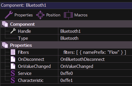

The complication is the "filter" expression. Due to domain origin issues in (most?) browsers, this needs to reference the actual device being connected to. There are examples in the tooltip for that property that show what is required. Here are 4 examples:
    filters: [ { services: [0x1802, 0x1803] } ]
    filters: [ { name: "My Cool Device" } ]
    filters: [ { namePrefix: "Mtx" } ]
    filters: [ { services: ["heart_rate"] } ], optionalServices: ["battery_service"]
You would also need to enter the appropriate Service and Characteristic too.

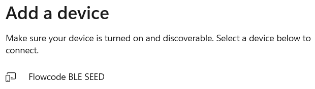

if I press the Button for "RequestDevice" nothing happens
Re: Web Developer with BLE
Posted: Fri Feb 20, 2026 2:08 pm
by Steve-Matrix
You could try the filter property set to the following, assuming this is the correct Service ID for your hardware project:
filters: [ { services: [0xffe0] } ]
I tried a test project on my mobile phone and I had to use the Chrome browser. I tried another browser and that did nothing, presumably because it does not have Bluetooth available to it.

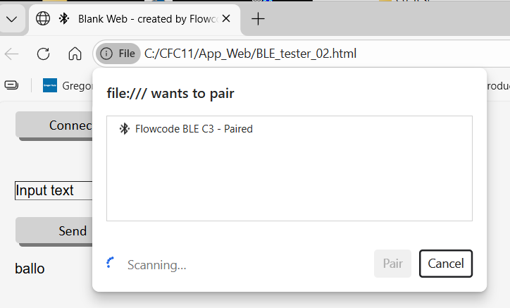

Posted: Fri Feb 20, 2026 2:37 pm
by stefan.erni
Hi Steve
Perfect!
This filter is working.
This is the HTML code on Edge working
I can receive nonstop text from the ESP32 via BLE
A small note:
with the filter
filters: [ { namePrefix: "Flow" } ]
I can connect but it's not working

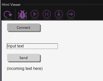

And....
It's not working in the HTML viewer.
