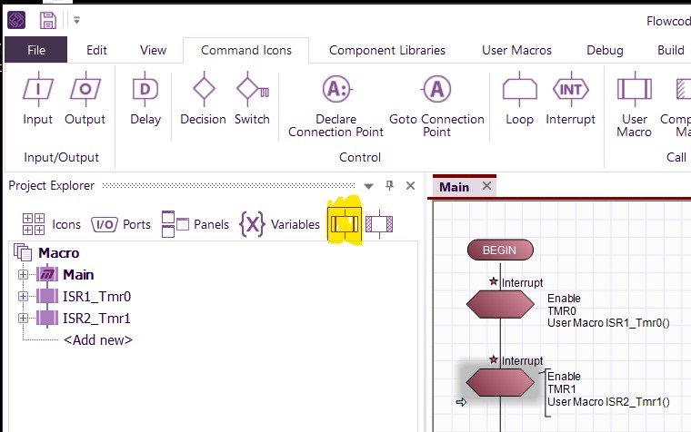

Perhaps include the timer being used in the macro name, then a quick glance in Project Explorer would show? There may well be a better way though.
- Screenshot 2026-02-23 160543.jpg (62.49 KiB) Viewed 3218 times
