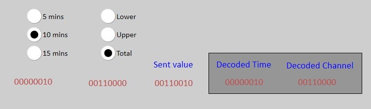

I converted ToBinary to FC - and tested in s8imulation. Here I just pass constants to the macro - although variables could also be used as the arguments.
If we added a BinaryToValue - that takes a string in binary and converts to a value - it would be easily converted to a (small) component...
I changed the code slightly - there is a small gotcha - (1 << n) only returns a 16 bit value - and as I wanted 32 bit capability - I used a separate mask.
I don't restrict the number of digits (eg 12 might be useful with 12bit ADCs)

It works as I needed, I only wanted the ToBinary but I am sure the other one will come in handy later.
I wanted to have 2 sets of radio buttons, combine their values into one byte (high/low nibble) and then separate them at the other end rather than sending 2 bytes.

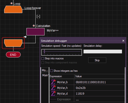

RGV250 wrote: ↑
Sat Apr 11, 2026 11:47 am
What would have helped is if I could have seen the values as binary while simulating.
Not sure if you are aware, but if you just want to view the binary value of a variable during simulation, then you have use a ",b" suffix in the variable view of the Simulation Debugger:
Screenshot 2026-04-13 090456.png (31.76 KiB) Viewed 4518 times
More info here:
https://www.flowcode.co.uk/wiki/index.p ... n_Debugger
