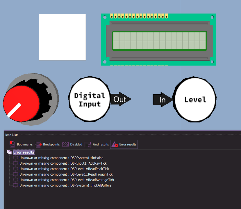

DSP Level Tick is missing?
How to use the DSP Level?
I like to ReadAverage from 200 samples but I miss a Tick.
I tried the sample on the help but the compiler is missing also a tick like me....
