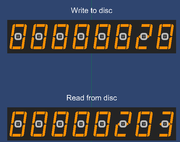

Hi Matrix Team,
There seems to be a problem with the seven segment display after update. It shows a load of lookup tables.
Thanks,
Wayne Millard

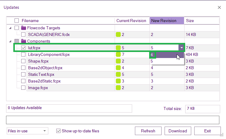

Until the issue is resolved there is a temporary fix.
Select Help, Library updates.
Tick Show up-to-date files
Under ComponentsTick LUT.fcpx
Change New revision from 5 to 4
Change LUT.png (32.86 KiB) Viewed 8590 times
Left-click Download.
Then Exit
Reload the flowchart.
