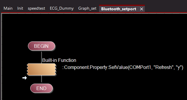

I tried App Developer Deployment and it's working fine,
but on the notebook the comports number are different
Is there a way to refresh and to change the comportnumber in the Deployd runing mode?
Re: App Developer Deployment: Use comport properties
Posted: Fri Aug 13, 2021 8:24 am
by medelec35
Hi, Stefan.
Do you have a Refresh Ports option within the API component properties?
Posted: Fri Aug 13, 2021 8:58 am
by stefan.erni
Hi Martin
Yes I did it it now

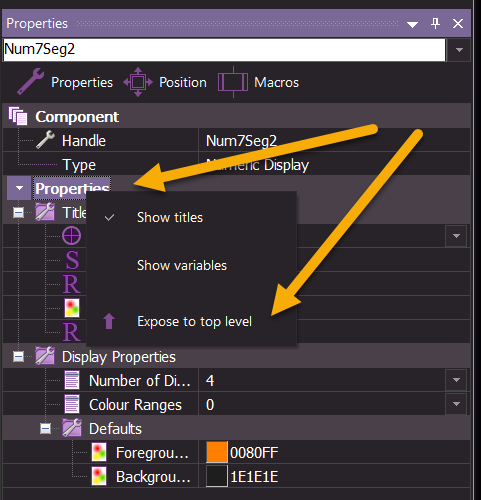

In the Deploit App I have a windows with component properties
I have no idea how it works, it always stays empty.
Posted: Tue Aug 17, 2021 9:29 am
by Steve-Matrix
In a deployed app, the component properties window only shows top-level properties - i.e. those you create for your project or have exposed to the top level by right-clicking them and selecting "expose" before you deploy the app.

Hi Stefan,
Don't forget you can expose the UART comport along with the refresh and any other options.

by stefan.erni
Hi Martin
Yes I dit it all and also from the chart I expose a lot in one go. It's fine.

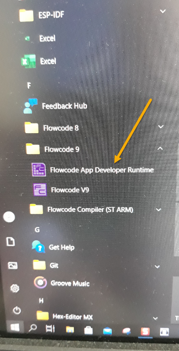

Somthing else about App Developper
I discovered a program in the windows menu:
Flowcode App Developer Runtime
I know such runtime from Matlab. I can simply install this on a computer and my Matlab program will work. Is it possible to download or install only the runtime from Matrix without FC9 so other users can install this once and all the.mscada are easy to use for them.
Posted: Tue Aug 17, 2021 5:19 pm
by stefan.erni
Hi Steve
I think the FC9 installer did this in the picture. Is it possible to have in
in the future an installer only for the App Developer Runtime.
So I can send the the mscada file and the downloadlink to the matrix homepage for the App Developer Runtime
Actually just an idea.
