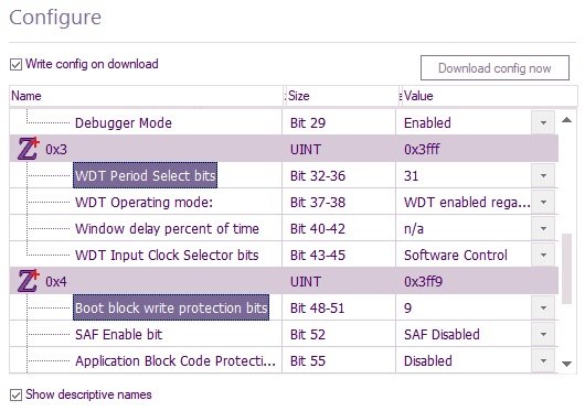

These two settings in your confguration look incorrect, can you check these settings,

Hi Ben , Hi erasmus,
Thank's both ...find here under the correct setting...
