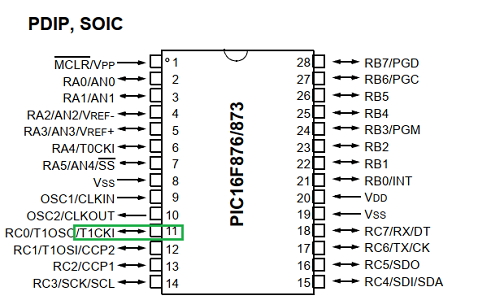

Thank´s Martin. As you see on picture, so far so good :D
But pin 15 is SDA C4for the display, and I cannot remap this pin. I dare not to change something in your program, can you change the input from the doobler to another pin input, please?
***EDIT*** Of course, I change the display from channel1 to software C4 > C5 Display still work but no speed readout in display. I also try to connect my signal generator TTL not help :roll:
Re: HB100 radar!
Posted: Fri Sep 17, 2021 7:24 pm
by medelec35
Oh, sorry.
Pin 15 is T1CKI on the 40 pin device.
You have the 28pin device, so its pin 11 for the frequency input.
