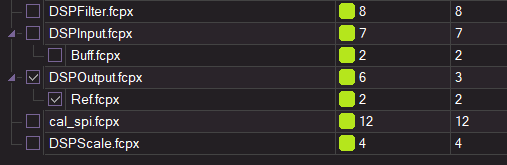

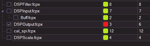

Just a DSPOuput version 6 problem?
If I go back from version 6 to version 3 the DSPOuput it's working again
There is no version 4 or version 5

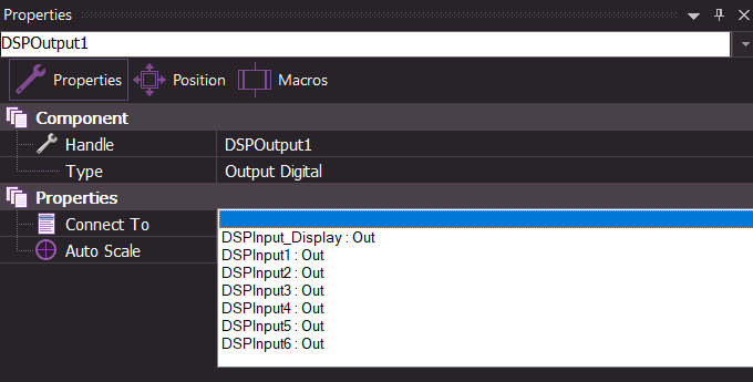

With the update it deleted again the connection to the filter
But there is a new problem:
connect the filter output (again) is not possible from the menue.
Re: DSP Filter update
Posted: Fri Nov 19, 2021 4:00 pm
by BenR
Thanks Stefan,
I've updated the filter component so it should be available in the list now.
