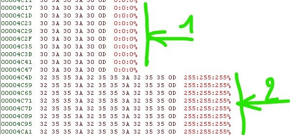

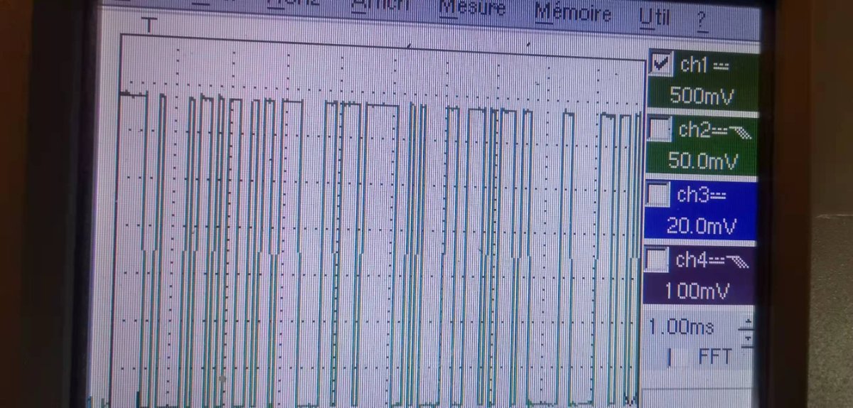

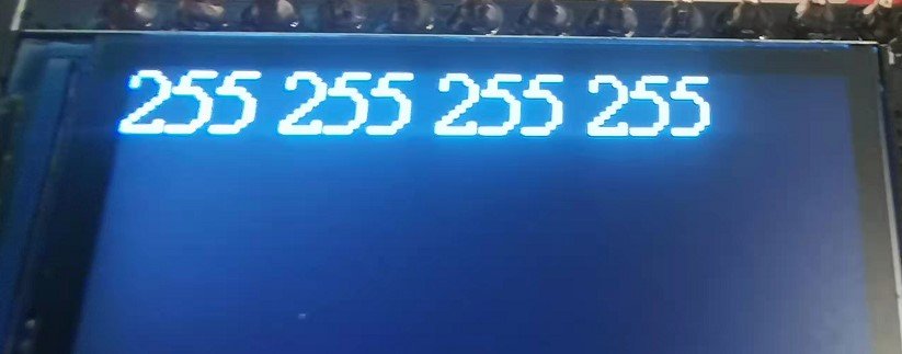

I'm using ESP32 TTGO Display to receive data from $PortA.26 with UART2 then transfer these data to Computer with UART1 (Tx $PortA.1, Rx $portA.3).
Problem is that UART2 received data are always 255 ! but as you cans see below, the signal to $PortA.26 is not always 255.
So I made a test with and without data input
- When data wire disconnected from $PortA.26 , input data = 0 see below
- when data wire connected from $PortA.26 , input data = 255 see below
Data on screen
I don't know what's wrong, please check.

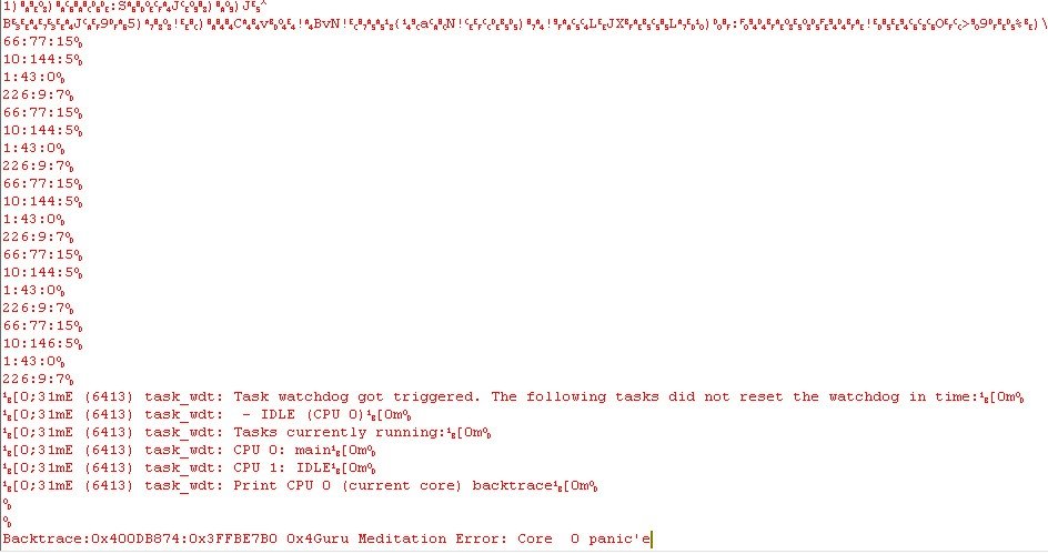

Thx Ben for your prompt reply, I just test it and the result is NG.
FYI, the data are from a sensor who is pushing 16 bytes every each second (1hz)
The first and second bytes to receive are always Byte0=0X42 and Bytes01=0x4D
For example,: 42 4D 0C 51 09 A2 07 2B 01 35 05 81 20 08 20 AD
66:77 received are ok --> 0x42 0x4D

Hi Seb,
Looks like you're getting some data through now.
What about this instead?
Data_Send2.fcfx
(21.92 KiB) Downloaded 1766 times
This waits for the first two bytes to be received, throwing anything else away. Once the bytes are received it waits for the buffer to fill with a complete reading of 14 data bytes. Once this happens it transfers everything through to the PC and prints out the first four data values on the LCD.
Watchdog delay reset was caused by the lack of delay in your main loop so I've put this back in now.
