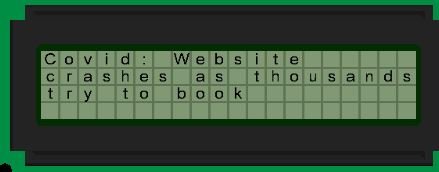

Hello
Is there an easy way to fit a long string onto a 20 x 4 lcd without the words getting split at the end, ie go down to the next line
when there is a space towards the end of the line your on.
I'm getting into a right state.
Mark

Hi.
Attached is the way I would do what you require.

Re: Fit long string onto 20 x 4 line LCD display
Posted: Mon Dec 13, 2021 12:16 pm
by Amtor
That's fantastic thanks, no cut in half words at all,
It's going to take me a fortnight to figure out how it's working. Sometimes if only 2 lines need printing the
previous 2 lines are still showing at the bottom but I'm sure I can figure out how to solve that at least.
I'll study the termination character.
Thanks very much to both of you for the help
Mark
