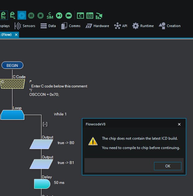

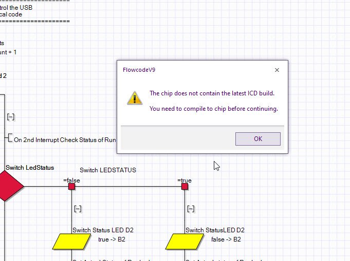

The famous Ghost error popup :D I have compiled to chip 100 times :D

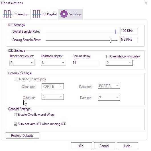

Have you got the ICD clock and data pin set in ICD settings?
Any further details to help narrow down the problem will be of help :)

The pins are set correctly RB7 Data and RB6 Clock
