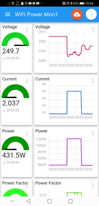

WingNut, all you need is a tiny micro e.g PIC12F1840, the Power monitor PZEM-004T and if you want a display, use an I2C or SPI version.
E.g 20x4 LCD with I2C backpack.
It does not have to be used with App developer, but it's great for monitoring.
For example, the data can be logged within a CSV file showing AC voltage, current power, power factor, frequency etc.
I have been using the ESP32 to send all the data to the internet, so I can access the data from my mobile, live from all over the world.
Power monitor live .jpg (45.02 KiB) Viewed 14636 times
This is using a Raspberry pi as a broker.
The only thing is there has been an update with the latest PI operating system to make it more difficult to do.
