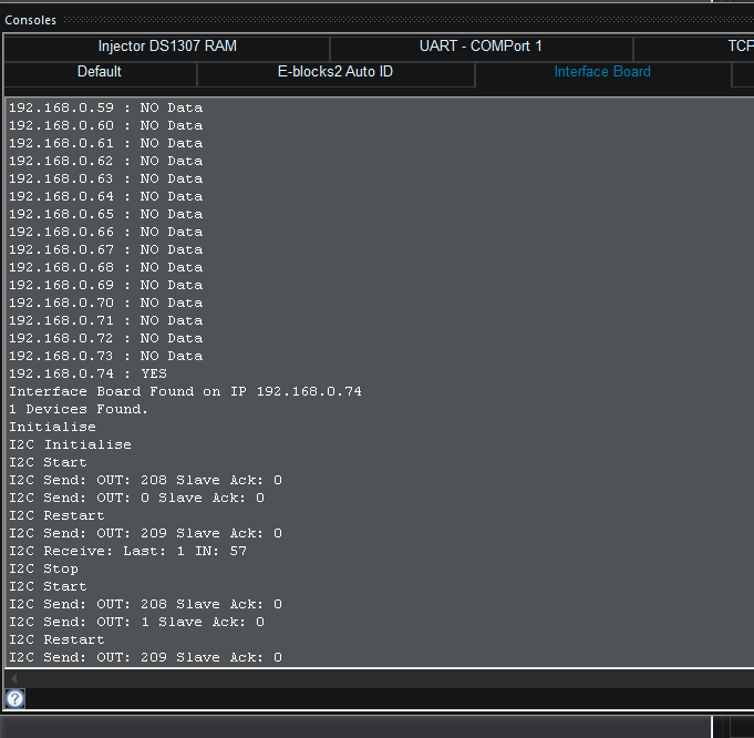

You can observe all the commands sent two and from Flowcode & hardware on the console.

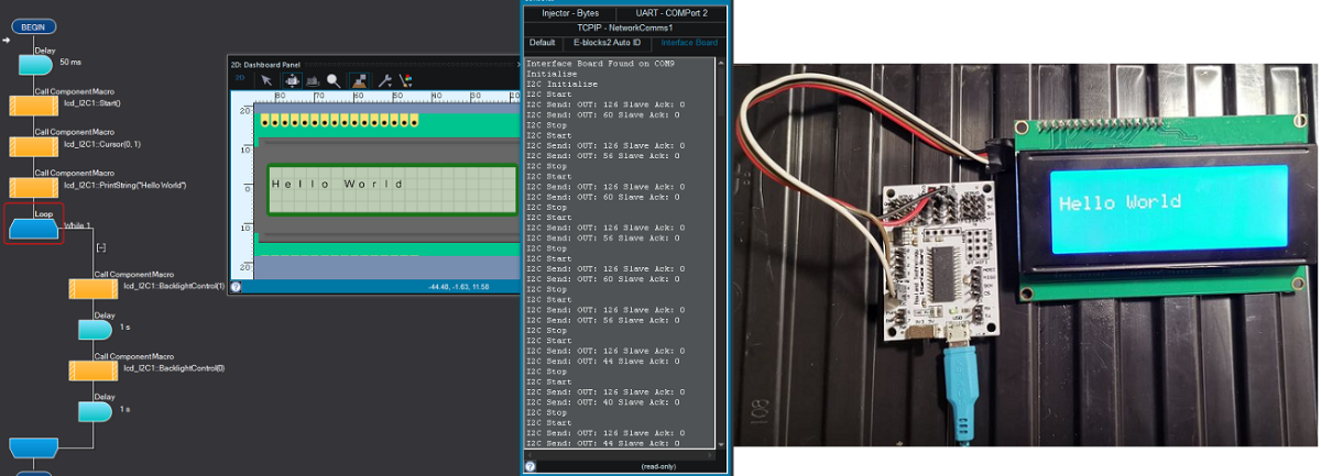

I will be using two lots of hardware to demonstrate with the USB version of interface board.
LCD with I2C backpack & Wii nunchucks.
If you have a LCD I2C backpack then just connect the LCD backpack to 5v supply and I2C SDA/SCL connections of the interface board.
Make sure switch on the interface board is selected for 5V & the jumper is going across LED 2 pin header.
I used DuPont female to female connections as I have got an interface board with all the male headers soldered on to it.
Plug the USB into the interface board and PC then load Run Flowcode.
Load the attached I2C Backpack LCD.fcfx
Within Flowcode select View Console and select Interface Board.
You can just run the simulation or single step by pressing F8.
The console will display com port that is connected to the interface board.
The brightness of the status LED will be dim except when commands are being sent or received, then will flash much brighter.
The hardware should match the simulation: As there is no hardware to program you can modify the flowchart then run the simulator again.
You will see all the changes on the hardware LCD.

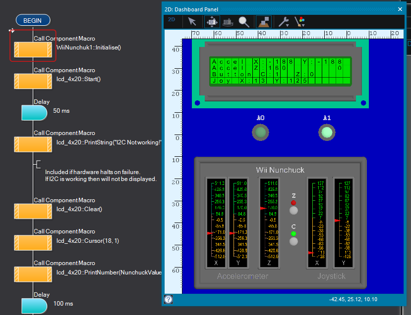

Nunchucks:
IMPORTANT: MAKE SURE THE VOLTAGE IS SET AT 3V3
Connect nunchucks to the power and I2C of the interface board.
Plug in the USB then Run Flowcode & load the Nunchuk_InterfaceBoard With LCD.fcfx flowchart.
After selecting Run, I’m now moving the nunchucks is different directions, holding down button C and pushed the joystick to the left.
As I moved the hardware, the Flowcode simulator match perfectly: Now I know without sending code to any targets, that my hardware will work.

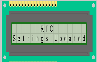

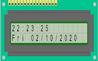

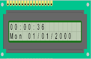

Attached is a version for the DS1307, DS3231 & DS3232 Real Time Clock.
As soon as Flowchart is loaded, If not updated Flowcode (Help, check for Updates...) on or after 02/Oct/20 then you will need to run the update.
Only hardware required is the RTC and interface board (Set at 3V3).
When you run Flowcode simulation, it will read the RTC hardware to obtain the date and time.
If either the time or date is out, you have just received a new RTC module or you just replaced the battery, in which the time will default to: All you do is select switch A0 until seconds stop incrementing.
As soon as you release the switch, the RTC module is automatically updated to the PC time and date: You will end up with the correct time and date on your RTC module: How good is that?
This will be a godsend if you have multiple RTC modules that require setting.
Note the Flowchart should also work with any target device without the interface board..
The switches are used to manually set time and date.
However that's the long way around of setting RTC!

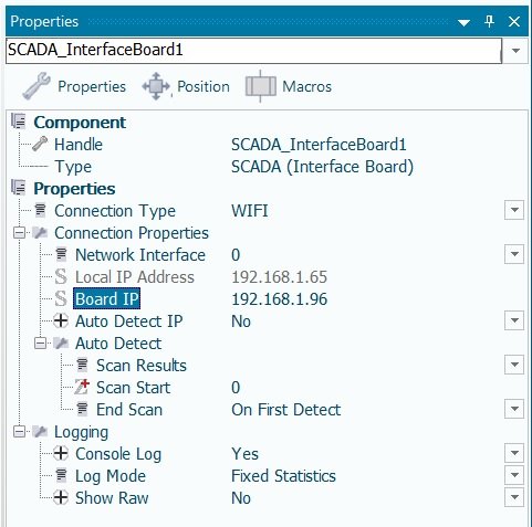

To talk to it via wifi you need to configure the Interface Board component properties like this.
Component is under API -> SCADA Slaves -> Interface Board
Change the network interface property until you get sensible values for the local IP of your machine.
Change the Board IP to match the module IP, you can do an auto scan to find the IP (takes a while) or you can refer to your WIFI router config page for the connected device list.
To control the interface board you can call the component macros directly or you can do what Medelec is doing and use SCADA Slave Injectors to catch I2C, SPI or UART data and forward to the interface board behind the scenes.
The Log mode property is best in Command Mode to allow you to see the comms in real time on the console window when running the sim.
Here's a quick example using a I2C enabled component.
Hope this helps.

Thanks - yes that works!
I'd missed the Network Interface step (although I'd tried a couple of different values - just not the right one
So after a long search - board found at 245!
Brilliant!
Brilliant!

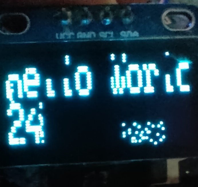

Hmm - sort of works..
Testing with i2c oled (which worked aok on usb) - the board sort of worked.
With a lot of LED flashing - the display cleared (mostly) and printed Hello World (also mostly)
But lots of corruption / missing pixels etc. Maybe a speed issue?
Re: Interface board for Flowcode V8 and above. Now added RTC
Thanks Martin, that's really interesting.
I'll investigate this and see if there is a way to improve the WIFI communications to make it a bit more solid like the USB.
