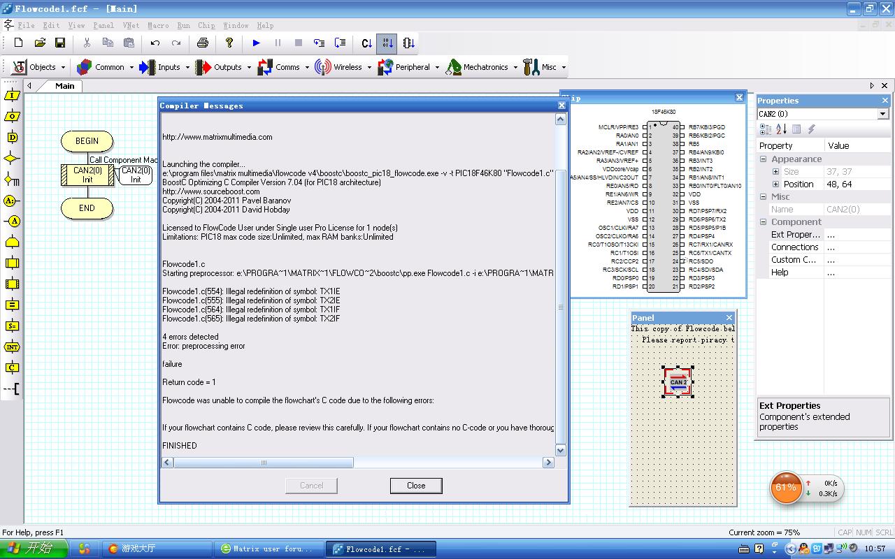

18F46K80 CAN2 Compile error,why? help me.thank you!
(199.58 KiB) Downloaded 3764 times

Hi nnnnff
I have created an unofficial fix for Flowcode V4.
Can you make a backup copy and replace:
PIC_CAN2.c that's in:
C:\Program Files (x86)\Matrix Multimedia\Flowcode V4\Components (If 64 bit windows)
or
C:\Program Files\Matrix Multimedia\Flowcode V4\Components (If 32 bit windows.)
With the attached file.
Hope it works for you.

thank you very much!

Even if flowchart compiles ok, I can't guarantee your hardware will work.
