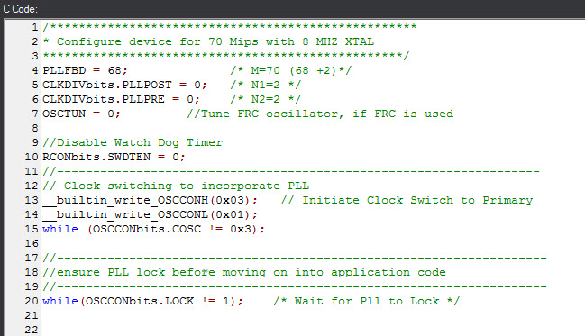

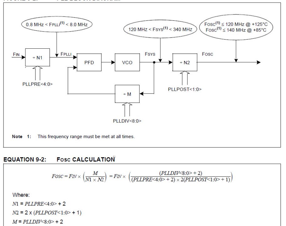

In my opinion in both your issue is related to the speed of your Oscillator settings.
In your Flow chart you set up 16Mhz Oscillator however in FC you need to use a C Icon and configure the Oscillator speed according to your needs by setting the N and M dividers which is part of the EP device.
Here is an example for the OSC config settings in a C Icon in FC (This is for a dsPIC33EP512MU810) running 70MIPS and use 8MHZ Crystal as clock
Regarding the ADC problem I would advise you to check the datasheet what is the recommended TAD then calculate the TAD and then setup the acquisition parameters FC as per your TAD calculation-
I do not have such a device to actually run your FC Chart so my comments are in general form
Ben will give us a hand here
Regards QMESAR

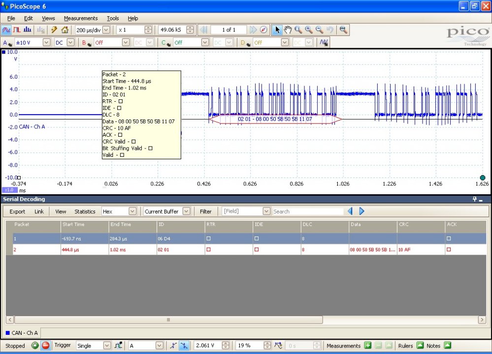

I'm still struggling with the CAN bus speed.
You'll have to bear with me here on what seems like a complicated test, but I have to use the hardware project I've got - I've cut out the extraneous stuff as much as possible.
I have an RF transceiver chip that reads a keyfob and sends the received key id and checksum as serial data at 15.625kbs.
In the attached code I'm doing the following:
Trigger the RF module by pulsing the control line with G2 (also flash the LED on B10 but that's just to verify it's running).
Receive the key data via interrupt on UART1 and verify the structure as <start byte> <8 key data bytes+2 CRC bytes> <end byte>. The key data & CRC are stored in the array 'key[]'.
Transmit the two CRC bytes (key[8] & key[9]) out through UART1 @ 15.625kbs.
Transmit the 8 key data bytes (key[0] to key[7]) in a single CAN msg with ID 0x201 @ 500kbs.
The attached scope capture, UART.jpg, shows the re-transmitted CRC which is 0xFB 0x0A.
This is the correct CRC for the actual RF key being used and shows the UART is correctly configured @ 15.625kbps
The other capture is the CAN bus and you can see the ID is correct (0x201) and the key data should be: 0x35 0x41 0x50 0x5B 0xB2 0x6D 0x11 0x07
The last two bytes are correct but the rest are pretty meaningless.
The main issue here is that this capture & decode is actually at 200kbps, so nothing like the 500kbps it's supposed to be.
So it appears my general config is correct as the UART works fine but the CAN is way off.
