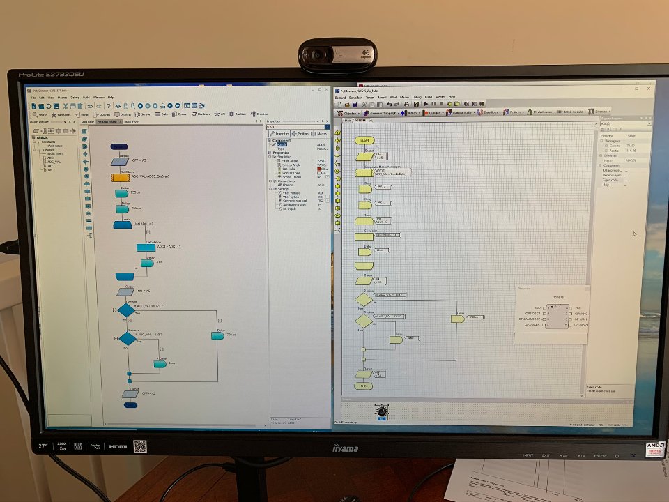

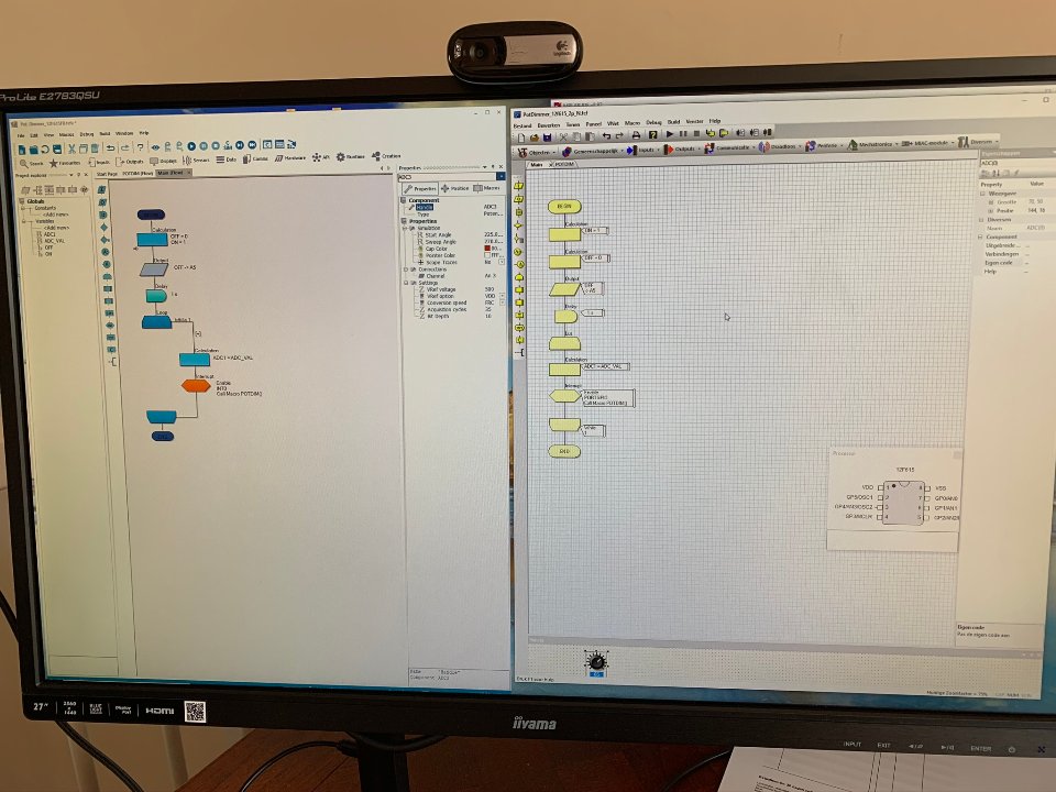

i just upgraded to version 8 and realized that V5 flowcharts could not be imported in V8.
So i made the same V8 flowchart by simply making a new one icon by icon and so on.
But after compiling i noticed that i had to reduce a delay component by roughly 7 times for achieving the same result. The flowchart is a 50Hz zerocross interrupt driven dimming device. After an ADC conversion it reads value of a potmeter with a byte as return value. This return value multiplied with the delay component is the firing angle for firing a triac. In version 5 this value is 22 us and in version 8 i have to decrease this value till 3 us. Otherwise it won't work. There is a lot of flikkering and undefined behavior. Could it have something to do with 10 bit sample depth of AN3 inV8? While in V5 this is maybe default 8 bit?
Is it possible to edit the sample depth? I would like a 8 bit, but i cannot find a way to edit this.
Device is PIC12F615. I hope pictures are good enough.

There are plenty of forum members like myself and forum staff that will be happy to convert V5 to V8 for you.venturi wrote:i just upgraded to version 8 and realized that V5 flowcharts could not be imported in V8.
You can PM if wanted to keep flowcharts private.
There is no cost involved.
venturi wrote:after compiling i noticed that i had to reduce a delay component by roughly 7 times for achieving the same result.
I would guess the issue is to do with overheads.
V8 uses XC8 compiler , whereas V5 uses BoostC compiler.
Maybe V8 is not quiet as good as BoostC with small delays, so you need to reduce value to get the equivalent?
Do you also have warnings when compiling like - Caution: Delay inaccurrate: 'delay_us', Delay overhead:0.01ms, Unit delay:0.001ms, Delay resolution:4 units?
Depending on your clock speed you may not be able to get the small delays required.
E.g 3 uS delay could really be a 10uS delay in reality.
