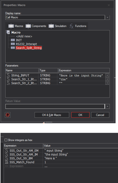

Some time ago I made this simple but very powerful Macro thought would be nice to share with the community.
Maybe someone could make a Component out of it I use this almost all the time.
The Macro takes an input string and another 2 search strings, It Searches for a specific word or letter in the input string
and outputs the following:
If used with only one Search String
input 1.png (78.2 KiB) Viewed 12334 times
SSS_Out_Str_AM_EM ( String After match but excluding match )
SSS_Out_Str_AM_IM ( String After match Including match )
SSS_Out_Str_BM ( String Before match )
SSS_Match_Found ( if match found =1 )

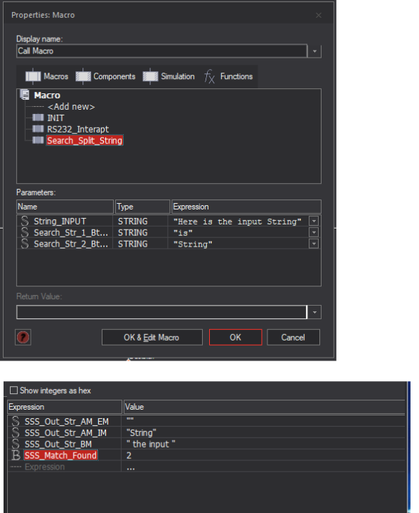

IF used with 2 Search Strings
SSS_Out_Str_AM_EM ( NOT USED )
SSS_Out_Str_AM_IM ( the second Search String )
SSS_Out_Str_BM ( String BETWEEN the 2 Search Strings )
SSS_Match_Found ( if match found =2 )
Made this on V7 but should also work on V8 enjoy!
