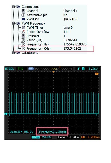

When I setup (for Nano)
Chn 1, Timer 0 as suggested for freq: 30kHz
by calculation section:
Period - 81
Prescale - 8
FC8 shows - 30kHz
The scope shows: 3.906kHz
When I change the Period to 111 and Prescale to 1
(photo below)
the freq is 31.25kHz
PS The scope probe is 1x
What do I do wrong?

When compiling do you get a warning that the period register is unavailable on the device?
If so where you have the period set to 111 it's actually set to 256 as the hardware doesn't have the ability to change the period.

You right Ben
It is.

ATMEGA328 PWM is not that controllable as Ben stated:
This will allow you to manually change prescale.
Set the period to 255(for indication only will not change hardware frequency)
Then actual frequency will be half of the indicated frequency of frequency_calc2.
E.g prescale is 64 & frequency_calc2 shows 976.562500 then PWM of hardware will run at about 488Hz
Reason requency_calc2 is showing double is you can't period to 256.
So for 31KHz just set prescale to 1.
The only thing you can do is make sure in the PWM Properties, Apply is set to NO in the calculations.
