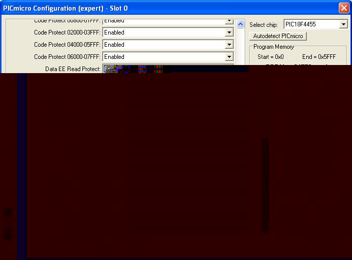

This changes the Code protect configuration bits to be enabled for memory locations 800-1FFF, 2000-3FFF, 4000-5FFF, 6000-7FFF.
Code protect is already enabled for 0-7FF.
There is also a table read and table write protect that stops the chips from being able to read or write memory directly. The above settings have these disabled.
You can use PPP in expert mode to see what exact configuration values will best suit your application. The hexadecimal values are shown on the bottom right hand side of the PPP configuration window.

Thanks for the information. My program uses some EEPROM memory to store and retrieve varibles used internally. I have a completed program that operates great, I am just concerned with someone reading the module. I would like to be able to write to module again but not have the ablity to read from it. I would like to be able to "update" the module if it was needed. I am a little timid in experimenting with the module and causing an unexpected result or locking myself out of it. What would be the correct settings for the arrangment I have described? Is it a matter of just changing the Data EE Read Protect?
Thanks for a great product.
Re: ECIO code protection
Hello
Yes the EE Read Protect should not stop you from overwriting the program meory or the EEPROM data but will prevent the EEPROM data being read back out of the device.
Enabling the Table Read Protect should give you the operation you are looking for with regards to reading back the program memory. You should also be able to reprogram the device after enabling this option.
