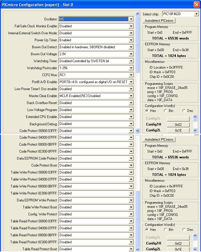

Re: Timing Issue
Hello Ron
The following configuration settings should work correctly for your device running at 20MHz.
