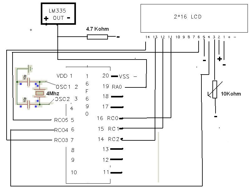

Re: Measure cold
Hello
Ok've drawn a bit on my connection.
Not the best but I hope you understand.
And I have measure the output of the lm335 and the value 2.040 V and the display shows -69
And the formula for conversion is the "Temperature = ((Read_ADC * 10 / (1023/100) * 5) +5) / 10-280
if this fails to work you should replace the sensor against someone else.
I have made sure that +5 V is stable.
Has had problems with not having a stable +5 V before.
Which gave me many problems.
But now it's okay
in the coming days to obtain the right of resistance that you write
I saw that I have 4Mhz crystal instead of 8Mhz.
VDD goes to plus
Foppa
Ps I use google translate which may explain my English

- Posts: 9521
- Has thanked: 2585 times
- Been thanked: 3815 times
Re: Measure cold
That is correct if o/p = 2.04V then temperature should be -69 deg C. Since the sensor won't be at that temperature, then the problem is the o/p is at the wrong voltage, not with the software.foppa wrote:And I have measure the output of the lm335 and the value 2.040 V and the display shows -69
Your diagram is not clear enough to check connections. To connect LM335 Adj is not used. + of lm335 goes to RA0 and to the supply resistor the other end of resistor goes to +5V supply. - of lm335 goes to 0V. Just as a reminder:
The simplest formula that appears to work is:
Temperature = Read_ADC*5/10-280

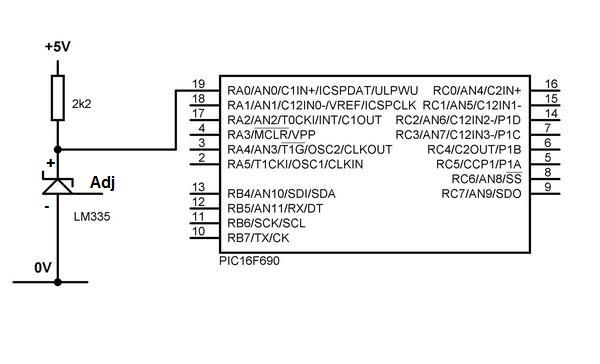

Great! Glad you got it working. What was the problem with your circuit ?
Unfortunately the drawing package is not mine, some kind person let me use it on their PC. It is called Proteus. Too expensive for me
I am looking around for a cheaper schematic package I can use.

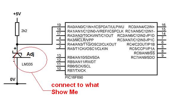

Re: Measure cold
Hold the horses medelec35
I was wrong
Since I am a novice in this, I need a bit more assists
How do I know where I will connect ADJUST or should not be connected
And what is o / p.
crap and I thought that this was ok
Foppa
I was wrong
And what is o / p.

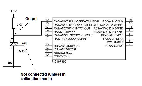

- Posts: 9521
Re: Measure cold
As stated in my previous post:
Take a look at the datasheet, it should help.
You only connect AJD if you are calibrating the device, then a trimmer stays connected to ADJ. Otherwise Leave ADJ open circuit.medelec35 wrote: To connect LM335 Adj is not used.
