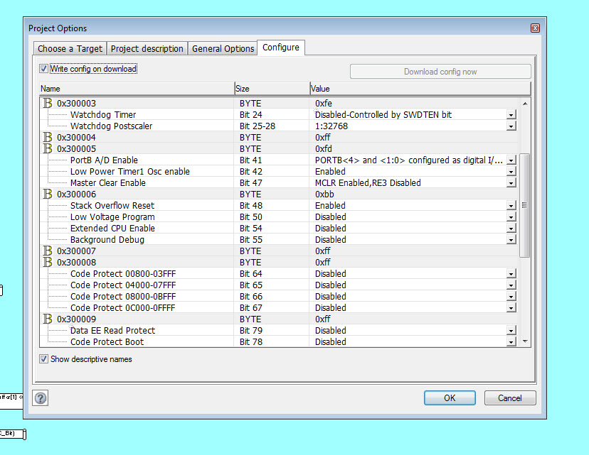

HIhow are you enabling/ disabling the extended instruction set?
Go to Build >> Project Options >> Configure and you will find it in the configuration window
- 21.01.jpg (178.99 KiB) Viewed 5728 times
Regards QMESAR

Hi E*2Engineer,
It may help if you can post a flowchart so we can see if we help you further.
But just in case the issues is the extended instruction set option:
With Flowcode V4, you will need to go to 'Chip', 'Configure'
There are two configuration screens.
Simple and expert.
You must have the expert configuration enabled.
If you can only see simple configuration menu: Then to save keep pressing 'Switch to Expert Config Screen'
You can enable Expert Config Screen by selecting 'Options', then unselect 'Use Simple Config Screen', select OK
When in expert config screen by 'Chip', 'Configure' menu you can then select Disabled for Extended instruction set: Note: What is called Expert configuration with V4, is the standard configuration screen for Flowcode V5 and above
