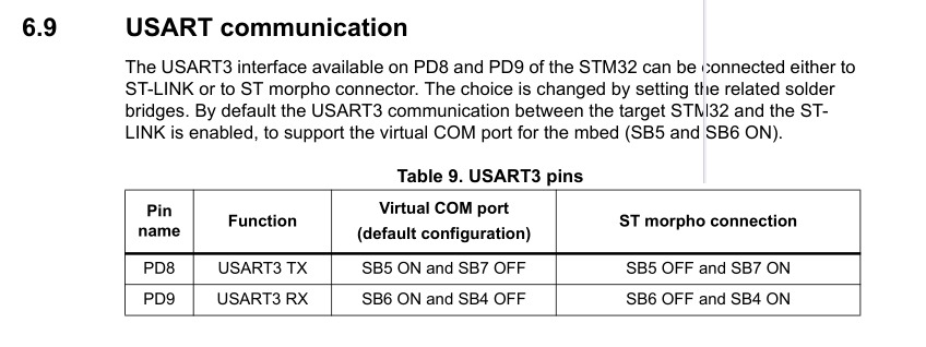

I am not sure about the conclusion when using NUCLEO-F746ZG :
Is there a chance to connect the USB directly to a PC and get serial communication
or is a separate USB serial card needed ?

Hi PicoPuls
I don't now....
But try the USART3

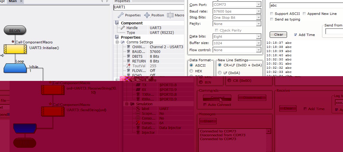

(6.69 KiB) Downloaded 6635 times

stefan.erni is correct. The Nucleo-F746ZG (and probably all other 144-pin Nucleo boards) use USART3, TX = PD8, RX = PD9 for the USB UART. No links or modifications are required.
I will edit my earlier post to include this information.
The information for the Nucleo boards seems to apply to all chip options of each pin count (32-, 64-, 144-pin).
Discovery boards not in the list will need to be checked individually for access to this feature.

I also don't understand what SB4....SB7 means

Now I found that SB stands for solder bridge
Does that need to be fixed before it works ?
At least SB5, 6, 7 are here

From table 9 above it looks like the default setting is USART3 connected to ST-LINK to support the virtual COM port,
which is what you want?

The solder bridges SB4 and SB7 should be removed, but if pin D8 D9 are not used,
they could probably stay

The attached program works on my F746ZG board. No hardware mods required.
F746Nuc144_VCP.fcfx
(6.52 KiB) Downloaded 925 times

If You start on the another way, it's more comfortable. The Nucleo is sending nonstop and You can just change Parameter or what ever on the computer. You can also see if You receive character in a wrong Baudrate. When it once works switch to your program.
(12.1 KiB) Downloaded 6629 times

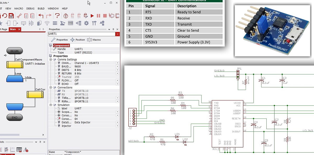

Thanks for the idea! Digilent-410-212
The Flowcode UART code has two connections TX, RX
and the Digilent unit has 4 connections TX,RX, RTS, CTS
Should RTS, CTS just be connected to GND ?

Let it open. It was working on my board without connecting.
