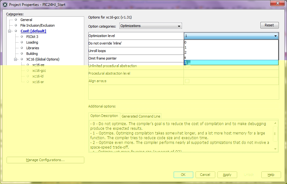

When I use MPLABX with XC8 and XC16, then specific for each project I set up the desired level of optimization as seen below:
XC8
XC8
XC8 optimizations - MPLABX.jpg (227.45 KiB) Viewed 9311 times
XC16
XC16
XC16 optimizations - MPLABX.jpg (242.75 KiB) Viewed 9311 times
Here is the help text from MPLABX about XC8 optimization levels:
This option selects the basic operating mode of the compiler. The available types are pro, std and free. A compiler operating in PRO mode uses full optimization and produces the smallest code size. Standard mode uses limited optimizations, and Free mode only uses a minimum optimization level and will produce relatively large code.
Here is the help text from MPLABX about XC16 optimization levels:
- 0 - Do not optimize. The compiler’s goal is to reduce the cost of compilation and to make debugging produce the expected results.
- 1 - Optimize. Optimizing compilation takes somewhat longer, and a lot more host memory for a large function. The compiler tries to reduce code size and execution time.
- 2 - Optimize even more. The compiler performs nearly all supported optimizations that do not involve a space-speed trade-off.
- s - Optimize yet more favoring size (superset of O2).
- 3 - Optimize yet more favoring speed (superset of O2).
