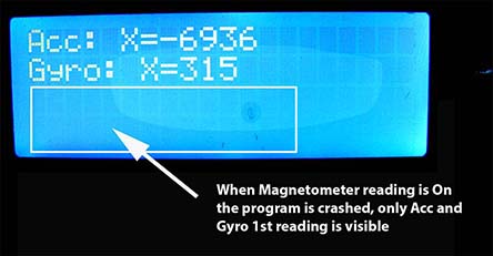

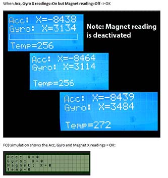

9250: Acc->OK, Gyro->OK, Magnet=Error
- Posts: 367
- Location: South Australia
- Has thanked: 45 times
- Been thanked: 63 times
Gear: Arduino Uno R3(smd), LCD20x4(i2c), mpu9250(Unbranded/Generic)
What is done:
FC8 is updated
Uno is tested in different project - OK
LCD20x4 is tested - OK

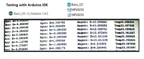

The same mpu9250 tested with same Uno- in Arduino IDE (Brian R Taylor project:mpu_9250_bolder_library) - OK
Any help?

I would guess it is getting stuck in the until flag_magnet_update =1 loop in the Magnet macro - so no new data is arriving,
if new data is received then the "no new data" message can never be reached (the flag will always = 1) - you could add a loop counter and give up testing after a specific number of loops (and I would add a short delay to the loop too?)
ie until flag_magnet_update = 1 OR tries =100
(I'd also make the flag variable local to the macro (and initialise it to 0 there (unless memory is very tight))

I think the flag can be 0 or 1.
I did what you said and increased the time inside the accelerometer loop and magnetometer loop.
Accelerometer returns 1.
Magnetometer returns nothing. Not 1, not 0. No readings at all. I think this is a problem

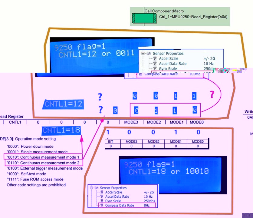

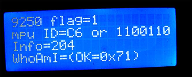

Reading the WHOAMI
Who Am I - reg117, address 0x75
The returned value was 113 or 0x71.
Sensor properties->Compass data rate or MPU-9250/AK8963 Sample and Readout Rate.
The AK8963 datasheet says that there are three modes for reading the data: SINGLE, CONT1 and CONT2. The CONT1 mode provides a data rate of 8 Hz and CONT2 provides the 100 Hz. In a Single mode ...the Sensor tag puts the magnetometer to sleep after every read (?).
Looks like Uno does not like the default setup of 8Hz and works only in 100Hz data rate. Again, I can be wrong, but it is the 'Continuous measurement mode 2' which makes Uno run.
P.S.: My register reading knowledge is zero. I hope Benj will find time to explain why CNTL reading shows 0...0011 instead of 0...0110.
