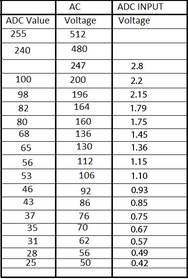

Here is the measured details attached.
RL-4 chatters at 167v, i have corrected 89 to 86, because 91-5v hysteresis =86, it was wrongly entered.
Please see the table and help.

Re: Automatic Voltage Regulator (AVR) using PIC16f72
Your ADC seems non-linear..that's not a very good thing in this design. You have to adjust in hardware to make it linear..I will advice you how to do that..for voltage sense and better switching of relay voltage sense should be approximately linear. Can you please post ac sense circuit schematic upto ADC pin..so that I can find which make it non-linear..
Thanks,

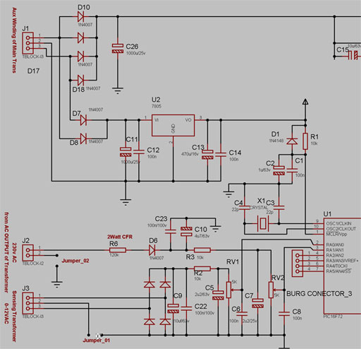

Thanks for the reply. The Sensing input schematic is attached, please see and guide.
Dear Mr Enamul,
Sorry, as out of station, we are late in finishing this model.
Actually i am not using any Opto Coupler in either models.
I am attaching the Schematics here for your verification and correction if any,
I am using this Schematic/Circuit and PCB for both the models, in my 1st model i am not using LCD meter.
You have quoted " Can you please check the difference between the input voltage step down, ac-dc, filtering and voltage dividing circuit for both of your model? "
All the components are same and no faulty components even.
With best regards
sks
With best regards
sks

Did you miss it or post later..I am attaching the Schematics here for your verification and correction if any,
Sorry Dear,
I missed the Schematic. Here it is.
With best regards
sks
With best regards
sks
- PIC16F72_StabilizerDesign_New.PDF
- (116.86 KiB) Downloaded 528 times
- Enamul
- Posts: 1772
- Joined: Mon Mar 05, 2012 11:34 pm
- Location: Nottingham, UK
- Has thanked: 271 times
- Been thanked: 814 times
No problem. I can't see anything wrong in the circuit. I think we have to adjust ADC input voltage and output and try to link the ADC input with AC by linear relationship.

I think I got the issue...If you look carefully in the table I have attached from your previous post..you can see ADC behavior becomes more non-linear at higher ADC input voltage and I have seen this kind of issue earlier. It's good to use lower portion of the ADC range as that is more linear. That's why I will suggest you to post the latest code so that I can modify that and suggest you to take some reading and post in the forum and hopefully the issue will be sorted.

If you use ADC value directly for voltage sense you will be limited to 255 as ADC can be maximum 255 and it seems there are some non-linearlity for high adc value; so if you use USE_AN0 =READ_AN0*2 that will change help you to read AC voltage easily 300V plus. Like if READ_AN0=255, USE_AN0=510; that means your range become double. But in reality you will be using 50 to 260 Vac may be; which means you are using 25 to 130 ADC value and that part of ADC is vary linear.
Now you need to do only one thing..you have to adjust the input of ADC in that way so that when the ac volt is 250, ADC value in LCD should be 125.
Here is a table..before testing the AVR..can you please test the table and put the analog voltage in the ADC pin so that I can check whether it is now linear or not. But before doing that remember to adjust 250V as 125 ADC value. If you want I can post a simple program just to check and fill-up the table.

Dear Mr Enamul,
Thanks for describing about ADC. Sorry i have not implemented LCD Display in my code yet.
I am posting the measured ADC Voltage value in different AC Input. Please tell me what to do next.
Shall i add the LCD Display in the code?

In that case how will you know what is ADC value for AC voltage?Sorry i have not implemented LCD Display in my code yet.
Yes you need LCD in the code to check linearity.Shall i add the LCD Display in the code?
What do you mean by wrong chip? Is that 16f72 you mean..that's not wrong just has less ADC resolution.I don't know why its so difficult to finalize this 2nd project, is it due to the wrong chip?

Data in the table is showing that this is not because of ADC rather your sensing circuit is some how non-linear. It could be the capacitor you are using. You can try with changing capacitor connected in series to 10K resistor.I will add LCD and post, I mean is it due to 8-bit ADC?

I have tested the hardware removing the 3.3uf cap after the 10k series resistor and adding a 1uf can at AN0, no improvement
found. just now i have added the LCD display in the code, yet to test in the hardware.
