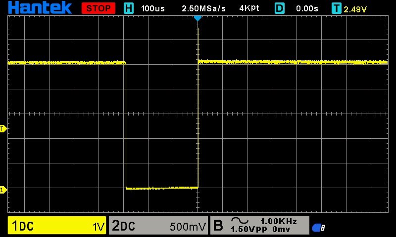

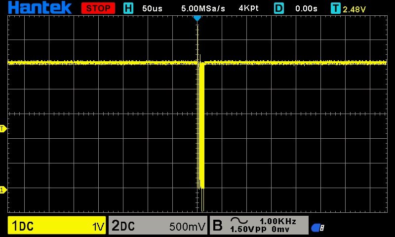

Good afternoon! However, he is not as kind as we would like. Imagine what I've learned! It turns out that the spi master module for sending data also does not work as it should: you cannot adjust the polarity of the synchronization signals in it, you cannot adjust the polarity of the transmitted data, and the worst thing is that the signals are sent so that even if the slave module worked, it would not be able to process the received data, since the cs, clk,mosi signals are not they coincide in time. In the attached pictures you will see.
- mosi_software.jpg (57 KiB) Viewed 68252 times
- clk_software.jpg (57.93 KiB) Viewed 68252 times
- cs_software.jpg (56.74 KiB) Viewed 68252 times

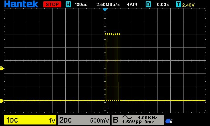

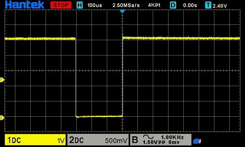

Good afternoon! You can change their polarity in the program using registers, I edited the original a little bit - I inserted the button and the lcd1602 indicator. But even in it, the signals do not match properly. I tried to set a delay-the cs signal became longer, but the time still does not match "clk" and "mosi".
- clk_positiv.jpg (59.14 KiB) Viewed 68251 times
- cs.jpg (56.71 KiB) Viewed 68251 times

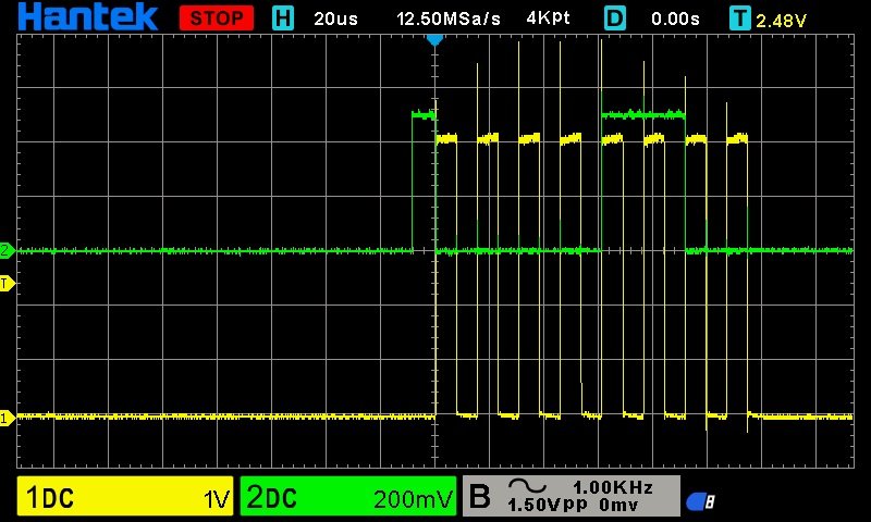

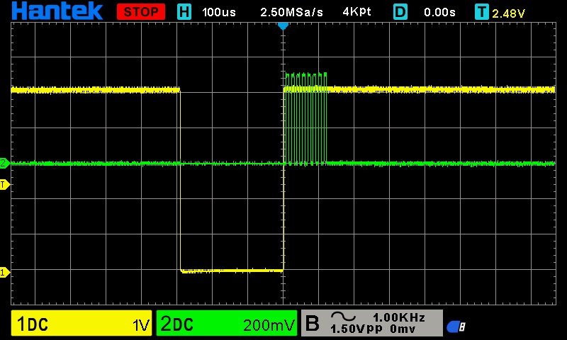

Good evening! I decided to test the signals using 2 oscilloscope probes. Unfortunately, the signals cs -clk, cs-mosi,clk-mosi did not match.
- clk and mosi do not match.jpg (70.38 KiB) Viewed 68229 times
- cs and mosi do not match.jpg (61 KiB) Viewed 68229 times
- cs and clk do not match.jpg (62.13 KiB) Viewed 68229 times

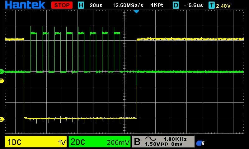

Goodnight! I found a way to fix the signal mismatch -at the end of the program I inserted a small delay of 150 microseconds. Otherwise, the relative position of the clk and mosi pulses can be adjusted by changing the register in the program.
- clk and mosi do not match.jpg (67.31 KiB) Viewed 68209 times
- cs and clk is match.jpg (65.81 KiB) Viewed 68209 times
- spi_send.fcfx
- (13.34 KiB) Downloaded 18286 times
