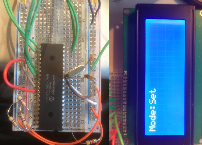

Hi Enamul, I am enclosing a pic of my setup
thanks
Acestu

OK Enamul,
Does my picture look right, the can tranceiver is dissconnected and the only things that are connected are the LCD, the 3 resisters and crystal and caps, would a 19.6 meg crystal make a difference if it is set to 20 meg ?
thanks
Acestu
Enamul
Posts: 1772
Location: Nottingham, UK
Has thanked: 271 times
Been thanked: 814 times
Re: RTC for Miac(Part One)
Post by Enamul »
19.66 or 20 MHZ doesn't matter..everything looks fine

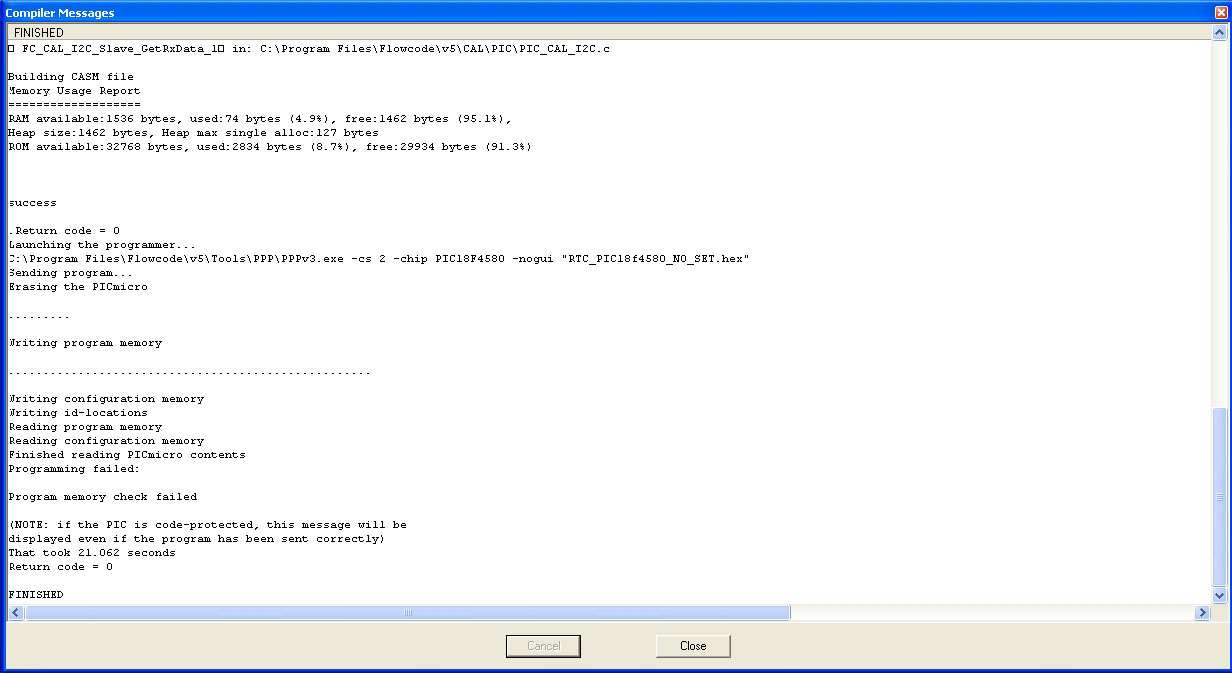

Post by acestu »
Hi Enamul,
When I use my dev board and ppp to program the chip I get this message, what do you make of this ?
thanks
Acestu
(91.19 KiB) Downloaded 2667 times
JohnCrow
Posts: 1367
Location: Lincolnshire
Has thanked: 364 times
Been thanked: 716 times
Post by JohnCrow »
Hi Stuart
Ive just tried your program on my Dev board and it will program into an 18F4580 with out any problems
Left your settings as is although my board has the default 19.66MHz xtal.
acestu

Post by acestu »
Thanks John,
I think this dev board that I have just bought is a duff, I have not managed to get it to program a single chip yet, I keep having to resort to my pickit 3, also my pc finds new hardware every time I plug the usb cable in ie I have to install the driver for the board every time I want to use it, if you look at the chip settings in the fcf file there is no code protect enabled, I think I will have to speak to flowcode about it.
thanks
